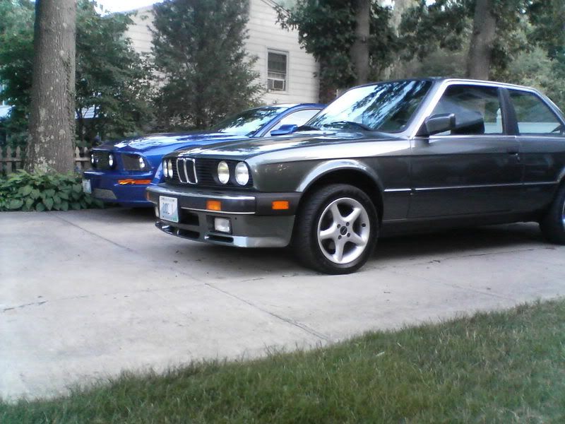

    dont even worry about it....they just sit in there....they look very unsafe but thats how they go just make sure you use the rubber top of the old spring from the top....
    b4
    after....with 1/2 inch left to go down

      Not the same company but pretty much the same product C3Motorsport coilovers are seen in my Sig
      all the way donw in the rear, 3/4 in the front
