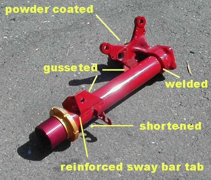

        Found out the E30 does not have a new housing but rather GC mods the housing for you unless you do it yourself... ($180 for modification for a pair)

          The above picture is a modified e30 housing. Doesn't look like E30s get a custom housing like other applications.
