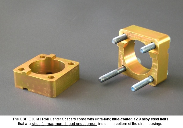

        For m3's or those running m3 bits, they are called roll center spacers...
