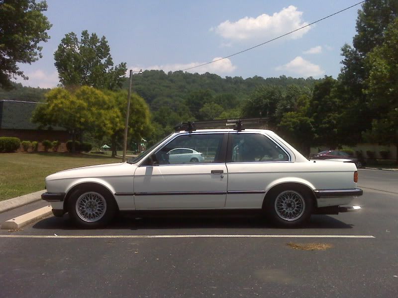

    I run GC's with mild spring rates, JT Design rear strut mounts, and stock strut hats in the front. Unmodified strut tubes. Bilstein sports. I replaced my tie rods, control arms, bushings, etc etc.. My car drives like a dream. Perfect DD.
    Here it is 3/4 down in the rear, and all the way down in the front with big ass tires and small ass rims:
    Here it is raised up 4 threads in the front, same in the rear. Same tires, diff wheels but same diameter:
    Not a huge difference, but rides smooth as shit, and I can actually hit shit in the road without worrying about my oil pan. I never scrape. And I'm still slammed.
    No offense E30Trash, but your looks awesome at that height, but its pretty much not streetable on a daily commute where you actually have to go places where you dont know the roads.
