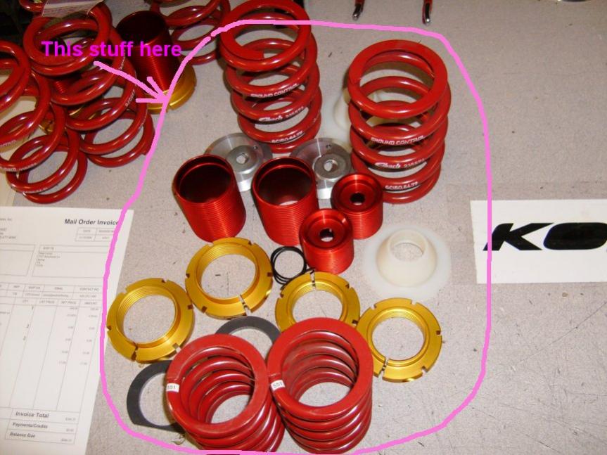

    Are those include front and rear setup or only the front setup ?

    front and rear
          Here is an actual pic of the parts included:

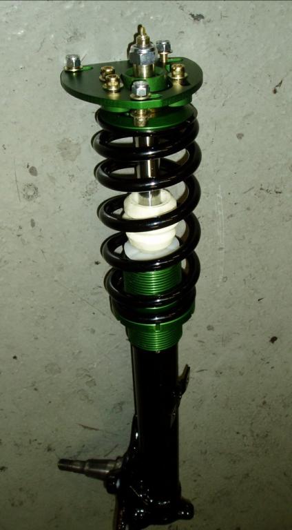

                    Yes. There is a $190 option that shows up when you order the parts, but in addition to shortening we pretty much do everything we can to the strut. Most people go ahead and do new wheel bearings at the same time.
                    We can also do different colors. Here is a 2002 kit (for a green car) that is powdercoated green and black, and all of the aluminum was green anodized. The powder coating color change does NOT cost extra, but the custom anodizing is $75 for everything.

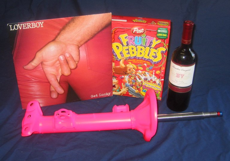

                          Yes, no problem. We even can do pink powder coating.
