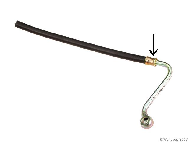

    Has anyone cut the crimp end of the factory hoses and used a new hose and clamp on the end?
    Or is my only option to buy new factory hoses?

      Originally posted by asubimmer
      sounds like its a good time to loop your lines and get rid of the PS
      Nah, I'd like to keep it if I can.
      Turns out I only need the supply and return line, NOT the pressure line.

          I'm talking about this crimp clamp.
          The cheap route is to remove this and attach a piece of the right size hose and use a regular hose clamp on the end.

              Originally posted by Naplm00
              oh sorry my fault
              thought you were talking about the crimp clamp on the resivior
              Can you do me a favor? If you're replacing the hoses tomorrow, can you see if you can take off/cut off this crimp sleeve in any way? Thanks...

                110 Bar + hose clamps=fail...
                OK for the supply and return lines, but if the pressure hose is leaking, replace it with the real thing.
                      Yea, I'm doing it on the return and supply lines NOT the pressure hose. For whatever reason the pressure hose is bone dry, but the other hoses are super leaky. Good for me.

                        trans mounts, oil pan gasket, motor mounts, trans outpus shaft seal, shift shaft seal, guibo, Center mount bearing, fuel filter (original! 133k lol), radio, winshield washer "T" AAANNNNNDDDD power steering hose clamps
                        all replaced
                        7 hrs, broken back
                        and yes, hose clamps will work fine, its just messy as fuck and a bitch to get the old ones off
                        I disconnected from bottom points, lifted res up, clipped off clamps, replaced with screw type

                          Ok, so you didn't replace the hoses, just the clamps....ok.
                          89 325is track project / 05 x5 / 99 M3
                          E30 stuff for sale | Parts I'm looking for
                          • Naplm00
                            • Nov 2008
                            • 1573
                            yep just the clamps, my hoses were swollen and they will need replacing soon, but for now this will keep the oil slick off the bottom of my car
