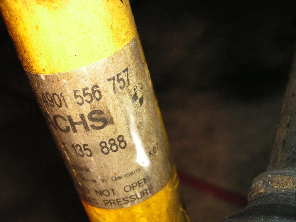

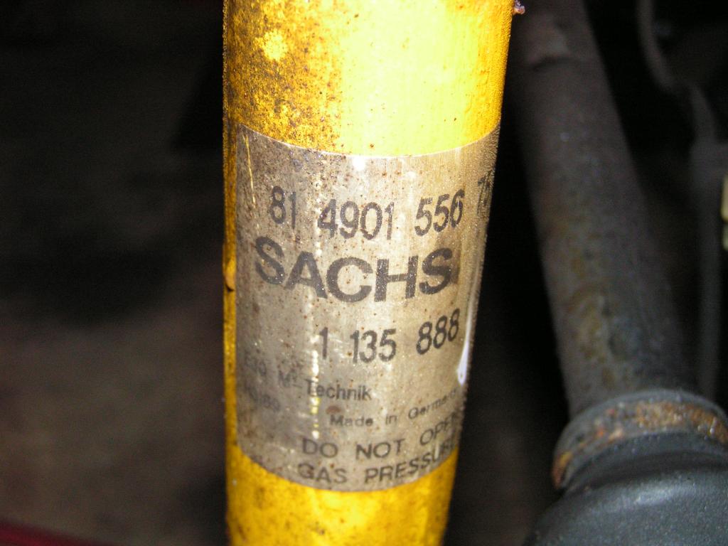

          So Ryan--the 88 325 I'm working on for the wife has these Sachs rear shocks on it. They say "E30 M Technik" and have a part # that isn't listed on realoem. What are they?
          • reelizmpro
            • 9552
            Gotta pic? someone probably changed them at some point. These cars are getting old ya know.

              Here's a photo:
              • TrentW
                • 2815
                Back from the dead. Anyone have info on these?

                    To the best of my knowledge, these are factory fitted shocks on models with m technic suspension. In the us, the only car that had that suspension is the 91 m technic convertible and the m3. I don't know much else about these as there are better, more available shocks that cost less. I do know that m3's came with boge shocks while these are Sachs. I don't know if the companies were merged together when the cars were new but they are the same company now. Both were low pressure gas shocks.
