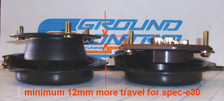

                  Bump from the dead.. Anyone have any pictures of the drop with the GC plates?
                  Considering it as an alternative to cutting a dead coil
                  • Hellabad
                    • 807
                    #39
                    I took off the license plate too. This is photoshopped 12mm lower in front.
                    the 12 mm is how much the spring pad moves upward, the suspension travel stays the same in this example.
                    Jay

                      If I understand all this information correctly, by using the shorter camber plates on the same spring, travel would increase by the amount the camber plates are shorter than the stock upper mount?
                      • E30SPDFRK
                        • 5716
                        #41
                        You understand incorrectly. Putting camber plates on the same spring would lower the car the distance they are shorter. The way Camber plates increase travel is if you put them on a car with coilovers. You would raise the lower pertch of the spring the height of the difference between stock and plates. This retains the same height you had but gives you that much more travel.
                        Camber plates on a car with springs will not increase travel, only lower the car.
