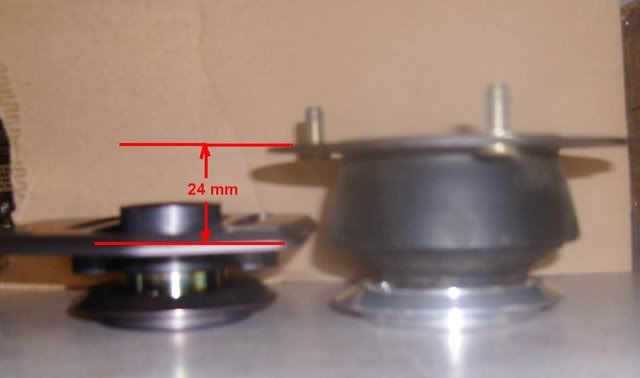

      The GC are 24 MM lower. Jay emailed me a pic. So it would make the car sit 24 mm lower in the front.

                    I'm looking at GC plates and slowly piecing together a full coilover kit of theirs. Was wondering if I get the plates first, what will be the result with my ride height.
                      This 24mm difference results in lowering, NOT raising the car, correct?
                      And the suspension travel is increased or unchanged?

                        suspension travel doesnt change unless you change your damper/spring combo.
                        suspension travel = full damper extension - full damper compression
                        so, if you install these camber plates on your current suspension, leaving all other things the same, your car will be 24mm lower with equal suspension travel.
                        gaining 24mm of travel with a camber plate is simply amazing. im coming from the subaru world where not loosing more than 10mm of travel was already good.
                        the only thing left that im wondering about is the front suspension's camber curve and how much of a penalisation it takes with lowering.

                            answer #1, with coilovers:
                            Good question. It is confusing because it depends on how you look at it. When you add (some) camber plates, there is a bigger gap between the top of the strut and the car body. You can do whatever you want with this gap. This gap is called suspension travel. You need a certain gap, or a certain amount of suspension travel to make the car so it doesn't ride and handle like crap.
                            So does thus "gap" have a magic number? Sorta. You need enough suspension travel to keep from hitting the bumpstops all the time, but if you never hit the bumpstops then maybe you can go a little lower for better grip. And for the chicks.
                            As shown in the picture, you now have an extra 24mm to play with. You can lower the car the whole 24mm and go cruising for Vida Guerra, or for example raise the spring 12mm and take the remaining 12mm to get better handling because you were bottoming out before that.
                            So in this example your car will be 12mm lower, and handle better because you have an extra 12mm gap before the front strut hits the bumpstop.
                            If you actually do pick up Vida Guerra at The Club, then you're gonna need that extra 12mm suspension travel / gap anyway. Maybe even 16mm on the LF.
                            answer #2, regular non adjustable height springs:
                            Simpler. Camber plates* will ONLY lower the car because you cannot make an adjustment to steal a little bit of that "gap" to make the car handle better.
                            The problem is if the car already has minimal travel, or too small of a gap, then tha car will be low and handle badly.
                            Bottom line answer: Usually, you take the extra suspension travel you have added, and take about half to handle better and half to ride better.
                            disclaimer: All struts bottom out, Bilsteins bottom out earlier than Stock, and WAY earlier than stock or Koni (or KYB or Tokico) with modified bumpstops. Modified bumpstops are just another way to get more "gap", and then maybe Vida Guerra has a sister to hook up with your friend.
                            * Some products are sold as camber plates, but aren't. They should actually be called "Strut mount spacers that move the top over and raise the car 10mm".
                            There are also camber plates that are a true camber plate that raise the car. These are lame.
                            There are also camber plates out there that lie about these measurements, which really sucks, because you don't know you've been lied to until it is too late.
