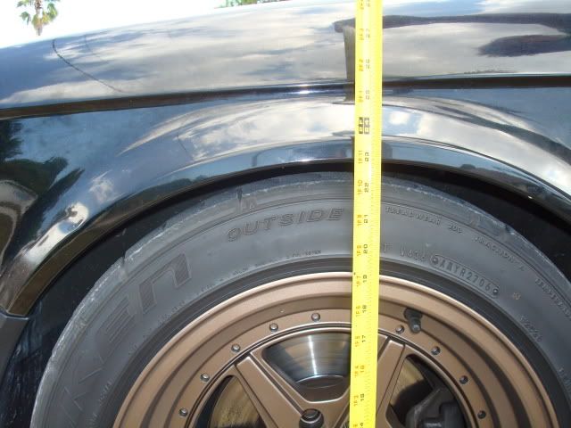

      before:

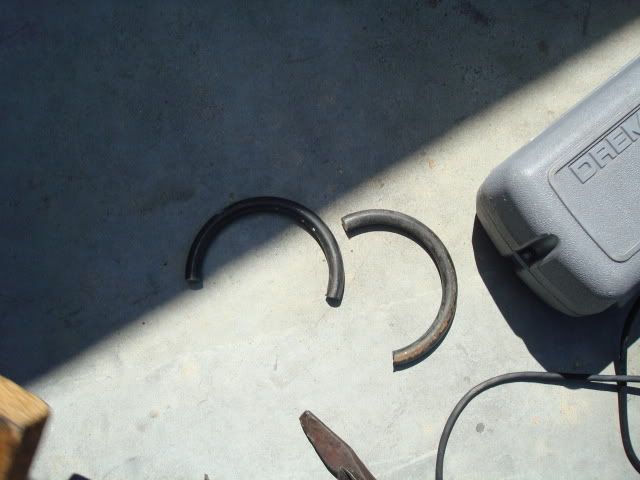

      removed just a tad more than half a coil from the bottom:

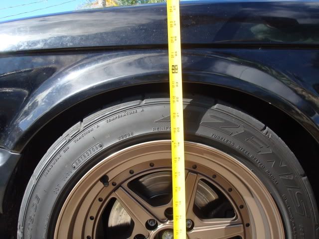

      after:
      results:
      The front of the car dropped about 3/8" with the removal of a bit more than half a coil. I'm very pleased with the ride height now and have saved myself the cost of a coilover kit. The spring rate may have gone up a shade, but that is no ill-effect in my opinion. I see no current problems and no future problems.
      note: these IE3s did not stay "seated" on the top and bottom of the perches when the front end was jacked up (before cutting). The spring could be moved slightly. So, obviously the same is true now, with half a coil removed. When the car was dropped back on the ground, the springs safely land back on the perches (BOTH before AND after removing 1/2 a coil). I zip tied the bottom of the spring to the lower perch and this works well.
      If you hate what I've done and think I couldn't be stupider, please leave without comment. Your opinion has been covered.
      It is my opinion that cutting 1/2 a coil did exactly what I wanted at no monetary, safety, or performance cost.

            I'll see what i can do about a wide angle comparison, but its probably more apparent in the close shots.
            heres another "after" for now

                It feels slightly firmer up front. Turn-in feels a little bit sharper (this is likely helped by the e36 rack I put in the same weekend). My guesstimate is that it may have increased the spring rate slightly by around 25 lbs/in. or so.
                I did no actual measurements of this- its just how it feels behind the wheel.
                I'll add to this if I feel any other changes.
                btw, a dremel cutting wheel worked perfectly. I didn't even have to remove the struts from the car. My spring pads were already removed, though. I don't know if it would be quite as easy with them in place.

                              well, the IE3s are already pretty low and to be honest, I was a bit concerned about bottoming out my bilstein sport struts. I decided to remove half of a live coil to up the spring rate a bit as opposed to removing a whole dead coil and keeping the spring rate the same.
                              I haven't had any problems and am happy with the slightly higher rate, but I feel that a whole dead coil probably wouldn't bottom either. I'd like to hear any experience with that route too.
