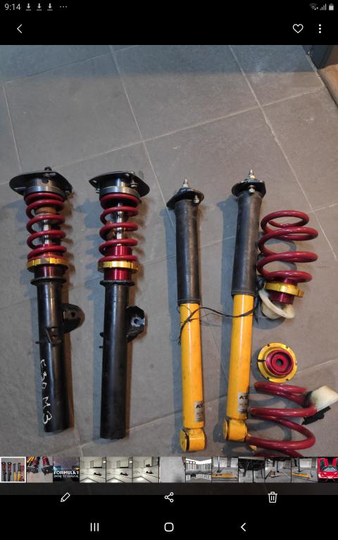

        This is the coilover I was referring to. As seen in the pic, the fronts seem to come in the housing. So I might take the cartridge out and install it in my sedan if possible

          These M3 front struts are missing the most important part: the entire knuckle and tie rod plate assembly. However, if the front strut cartridges are intact, you can remove them from the housings which are now useless, and install them into your strut housings, assuming you have the late model 51mm housings. These will not work in early model 45mm housings.
            I'll try it then.
            My car is 1990 facelifted model. So should have the newer shocks
