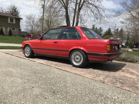

      I have been running Super Sports on my 318is for 3 summers now and love them. Paired with Koni adjustable yellow struts. So far I have zero complaints with the right height or price, although I will be doing E90 hats on the front to get just a bit more low next summer. I daily drive my car some times in the summer, around downtown Toronto and into the back country twisities and it handles everything very well.

        Here are some pics of how the car currently sits with the H&R Supers and Koni Yellows. No E90 hats yet though...

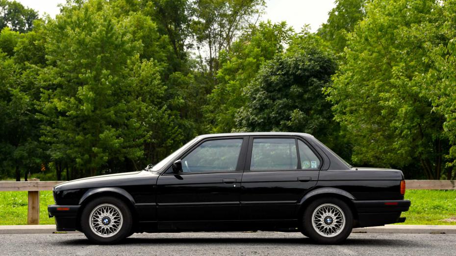

                          I made these some time ago but never shared. I went from OEM, to a H&R Cup Kit and H&R 50406's (Super Sports). Here is a comparison. Sorry about the lighting in some shots:
                          Click image for larger version  Name:	HnR_profile.jpg Views:	0 Size:	67.7 KB ID:	9975771
                          Some measurements (front, rear, and then to a Red46 skid plate. OEM top row, Super sport 50406 middle, cup kit bottom):
                          Click image for larger version  Name:	HnR_heights.jpg Views:	0 Size:	90.0 KB ID:	9975772
                          With both H&R setups I have a 20mm spring pad and IE Spring spacer in the rear for some rake. Late model tucked too much for my liking. The Cup kit was too low for me. The 50406's got the look i wanted and the ride quality also.
                          Tires are 195 60/14. Entire suspension has been refreshed. Been running 50406's for almost 5 years now.

                            Here is a picture from last August 2020 with it fully settled on 50406s:
