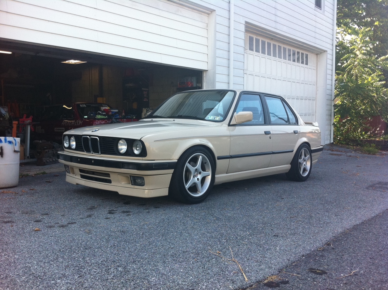

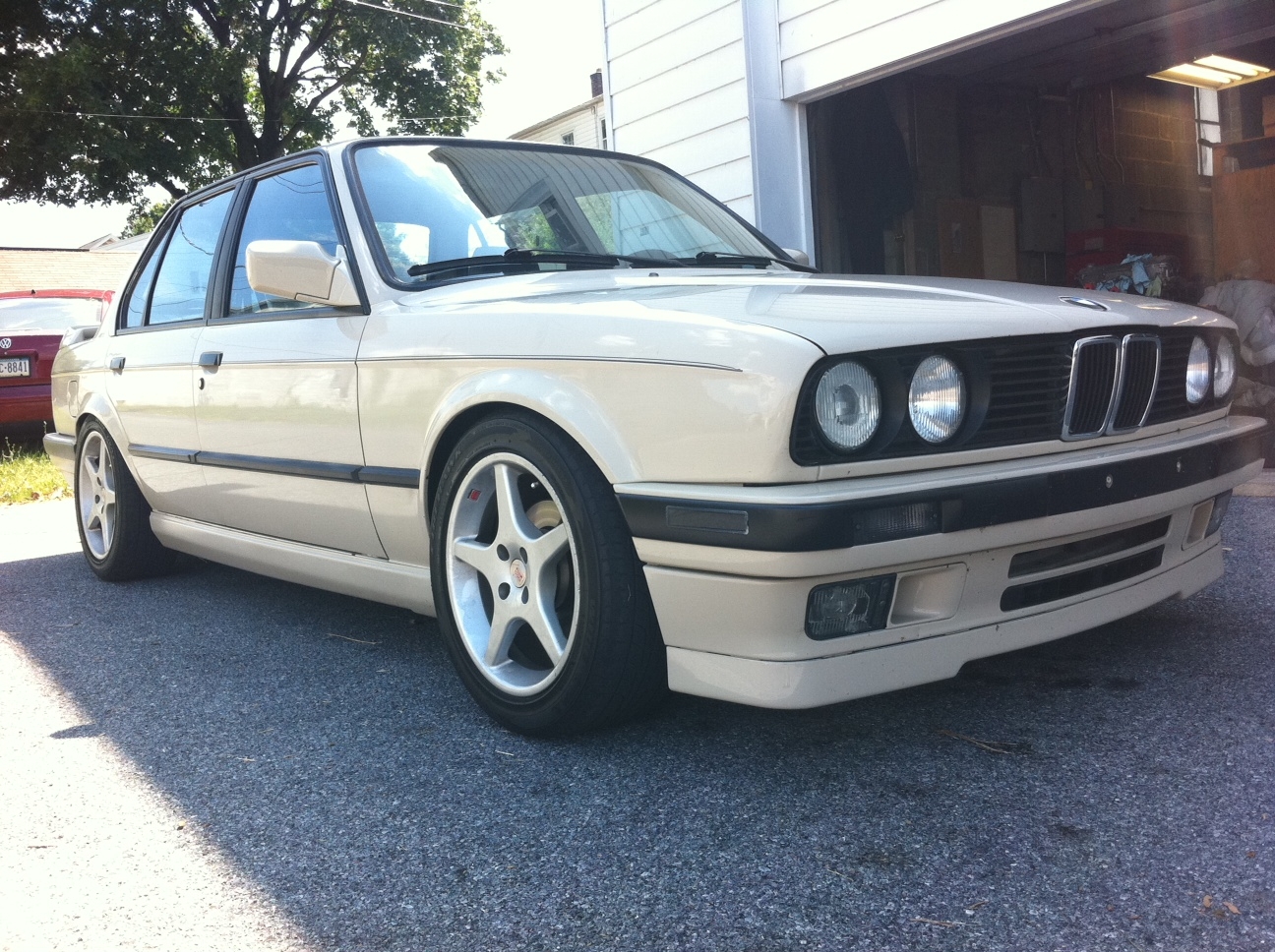

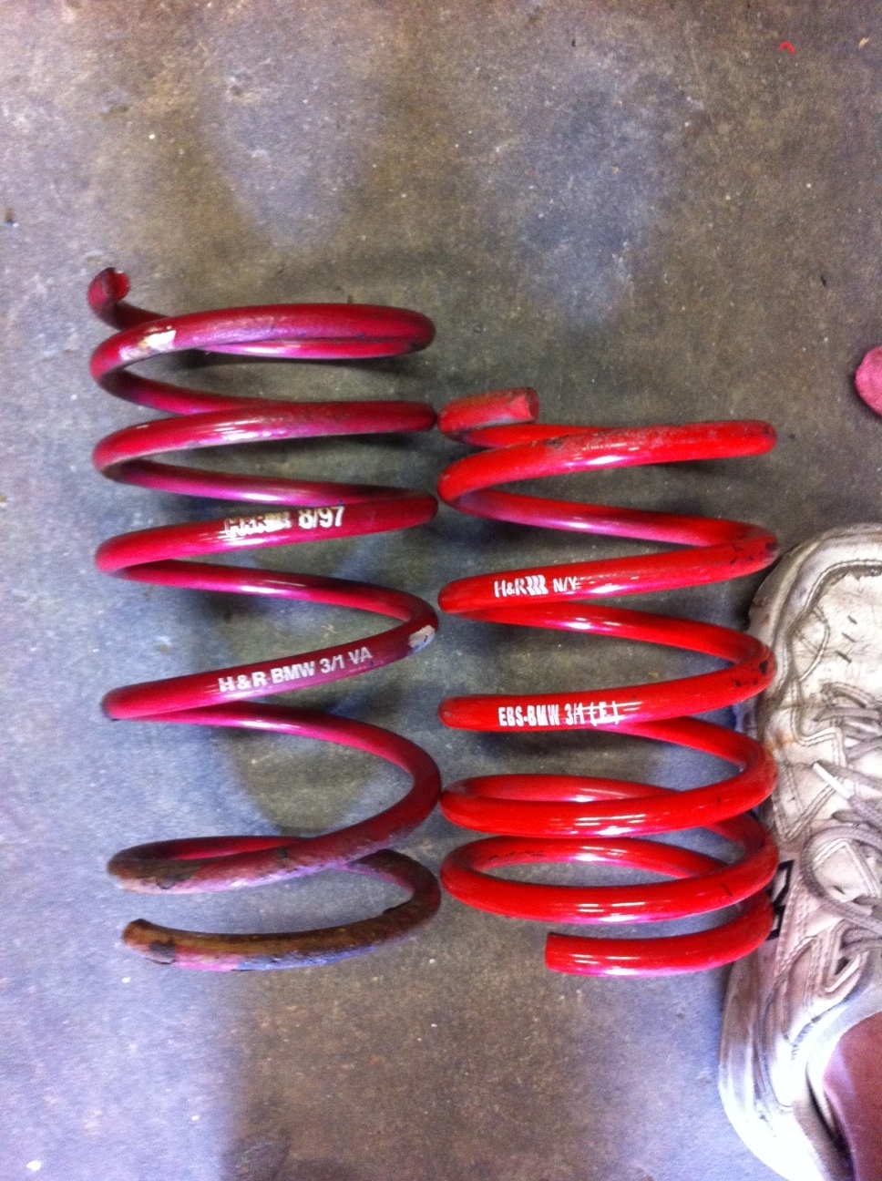

    Sport on left, Race on right
    Race on left, Sport on right
    Ride height stayed identical, didn't change one bit. I have e90 drop hats installed. I didn't even bother taking an after pic, because it's literally the same. Tire size is 205/50/16. No spring pads front or rear. Sports have tons of miles on them, races have ~5k miles, so both are settled.

    Thanks for the pictures! No drop aye? Is your car close to stock weight?
    I've wondered if a lighter car would experience more of a drop between the two based on the cars inability to compress the "sport" springs closer to the ground. I've got sports right now (essentially picked them up for free) but I feel like I ride higher than most people on sports.

      That car is 2720 lbs. The red car in the background, my track car, is 2410 lb, and with those H&R Race springs (that's where they came from), sat higher then my tan car. I agree, it's due to the inability to compress them. But I don't think Sports would be any higher.
      Basically all I proved here is that H&R Race has the same ride height as H&R Sport, but the Races offer a much more desirable spring rate, unless you drive on cobblestone daily. I think they are actually better matched to Bilstein Sports then the sport springs are. My Sports used to bottom out all the time, these don't come close. And the body roll is gone, as is the horrible dipping in the rear when getting on the throttle hard in 1st/2nd.
      I'd recommend Races over Sports any day.
        At a given weight. Presumably if you added another 1000 to each wheel that the sport would compress and drop further than the race. And in fact we can see that completely unloaded that the sport are taller than the race.

                My problem was, the Sports are so soft, that coupled with the e90 drop hats, they would bottom out ALL the time. So the ride was actually worse. It got to the point where my radio was shutting off, glove box was falling open, etc... (I drive on some pretty bad roads) When the shock bottoms out, you have zero give. My shock towers actually started to crack, and I'm 99% sure that's why. With the Race springs, it doesn't bottom out, and the ride overall is smoother. I would 100% recommend them for a DD. They are in no way 'harsh', IMO.

                  I've seen new sports that sit much higher then yours, is it possible that yours are worn out and sagging? They look pretty rusty.
                      Sagging? i'm sure a little. But keep in mine I have the drop hats up front (~10mm = almost half an inch), no spring pads on all 4 corners, and have a ~80lb sub/amp setup in the back. Total car weight is 2720, but I never had it corner weighted so I can't be sure of F/R. Weight has a LOT to do with it, my track car with H&R Races has a good 1" wheel gap at each corner.

                          your springs are sagging normally sports are 4x4 up front still. i would go with nothing less than H&R race.

                            No, they aren't. As I said, I have drop hats, no spring pads, and the car is heavy (m50, large subs/amp, etc...). I have pics from when I first installed those springs years ago, the ride height didn't change up until a few months ago when I put in the drop hats and removed the spring pads.
                            I just installed those Sport springs in my track car and it has an inch of wheel well gap.
