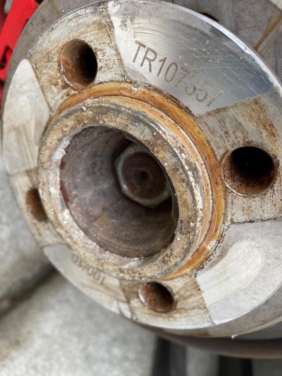

    Hey all,
    I just purchased a 91 318ic. It came with some aftermarket discount tire 4x100 17inch wheels. I purchased some stock bottle caps to bring it back to original condition. Go to put the wheel on and it won’t fit. The hub measured 70mm.
    is it common for someone to install a new wheel hub that isn’t oem? I assume my only option for stock is to purchase original hub / bearing?

      thanks for getting back. It doesn’t look like a hub ring. Looks like a spacer with a larger hub? See picture

      • 82eye
        • Jan 2009
        • 2095
        i think it's just stuck. looks like a hub centric spacer.
        • mjweimer
          • Dec 2015
          • 648
          OK, same basic principle as the hubcentric ring but with the added thickness of the spacer to make the offset of the aftermarket wheels better fit the car. Removing those spacers should reveal the stock hub.
          If the aluminum has corroded on the back side of the spacer you might have some fun getting them free. Some spacers have slots to help free them up when this happens but others sit flush....hopefully they don't fight you too much.
          Adding to my comments above about the wheel bolt taper, generally with a spacer, the length of the wheel bolt(s) increases to compensate, however it does depend on the thickness of the wheel hub. I mention this only so you know to compare the length to the stock bolts and avoid them rubbing on anything behind the hub. You can get by with a bit more length, but not too much....if they are close, install and then rotate the wheel to listen/feel for interference.
