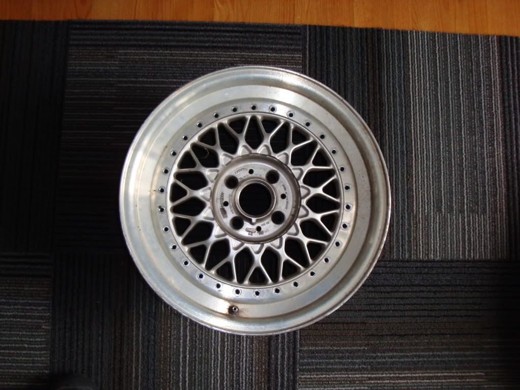

    Intact:
    Bolts removed:

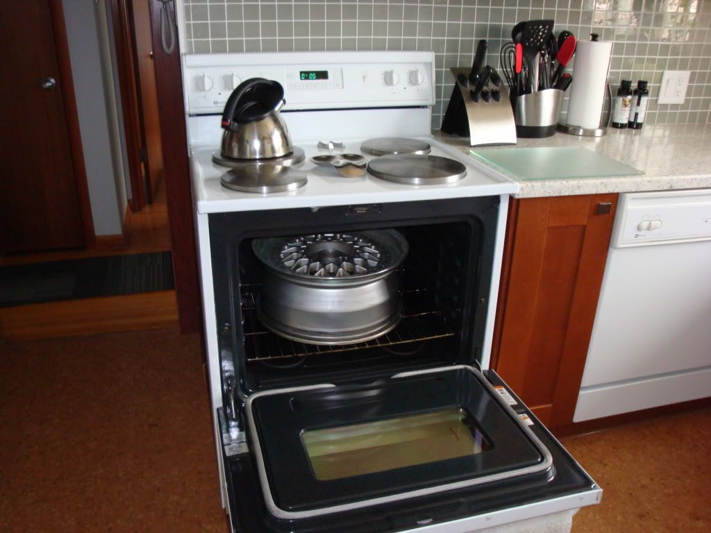

    In the oven: 350F for 5 minutes... DON'T BE A RETARD, USE OVEN MITTS WHEN YOU REMOVE THEM. Girlfriend wasn't impressed, told her she never used it anyways... less impressed.
    Looks tasty...

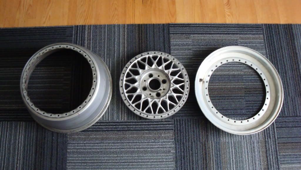

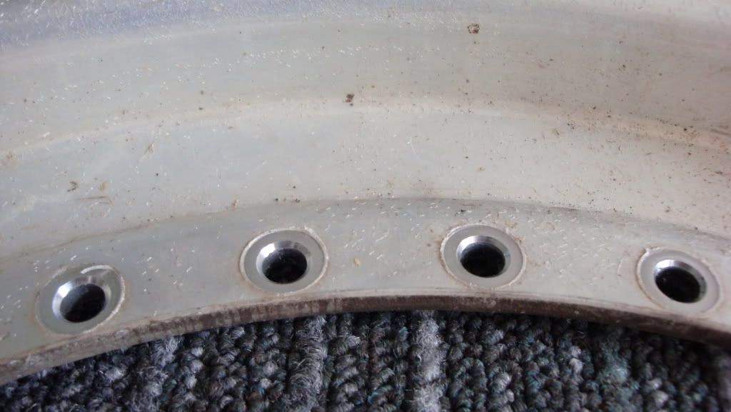

    In pieces: (this is where you use the rubber mallet) Also, before I seperated them, I marked them with a permanent marker, indicating wheel # and where they had been aligned (drawing a line across all three pieces)

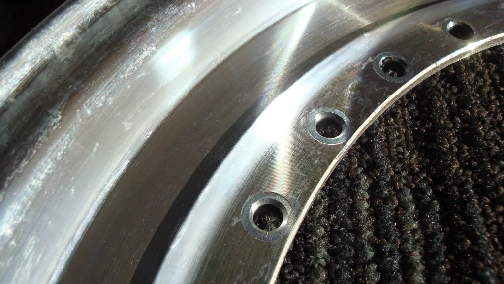

    Close up of clear:

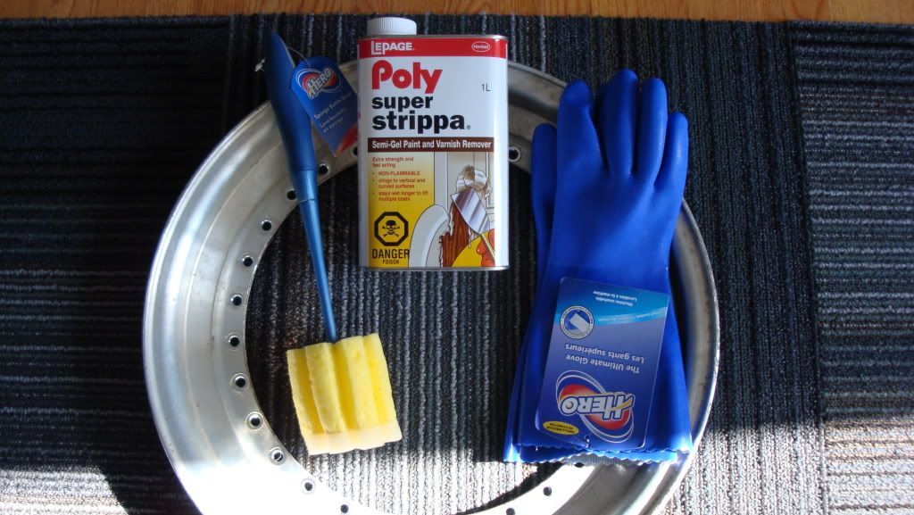

    Cleaning products: (tip, buy gloves that fit... trust me) Bought teh super strippa cause it made me laugh. Proceeded to refer to girlfriend as "Super Strippa"

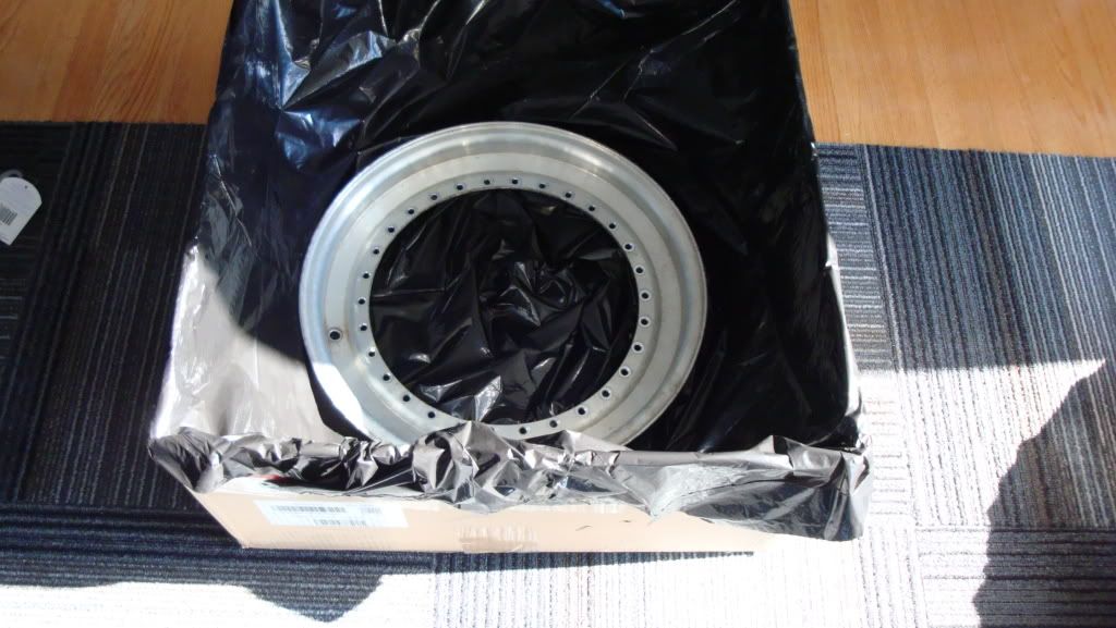

    Makeshift cleaning station: Printer box, chopped down, with a garbage bag liner.
