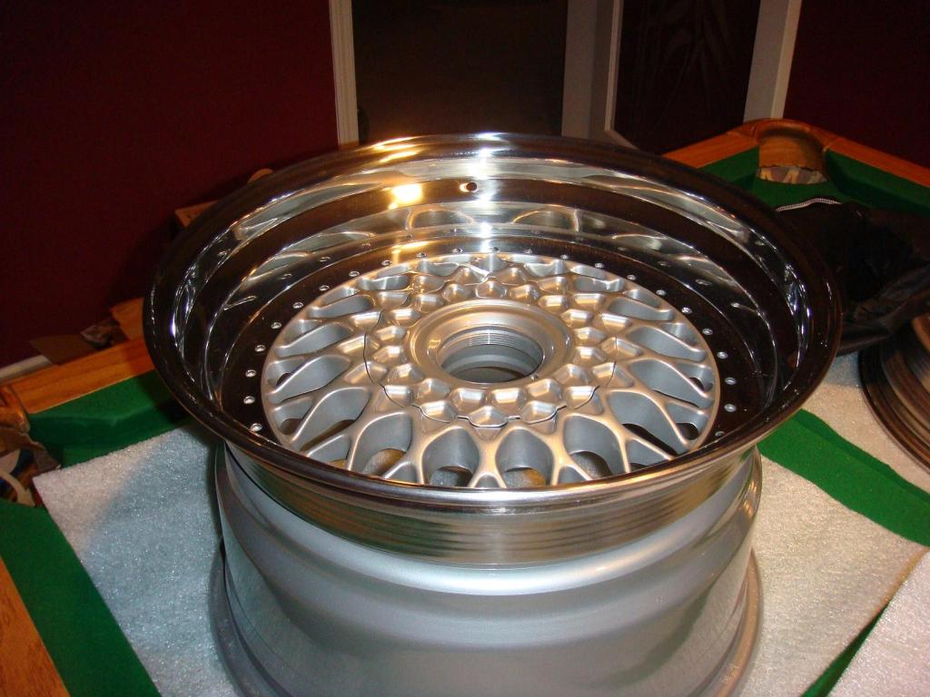

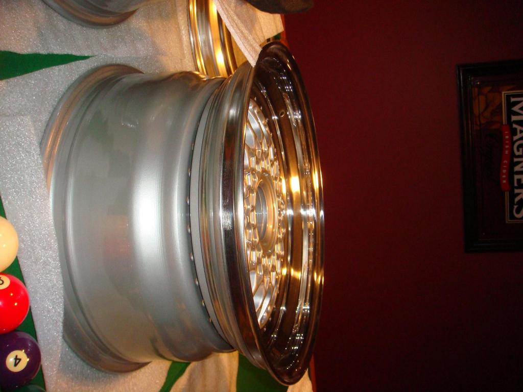

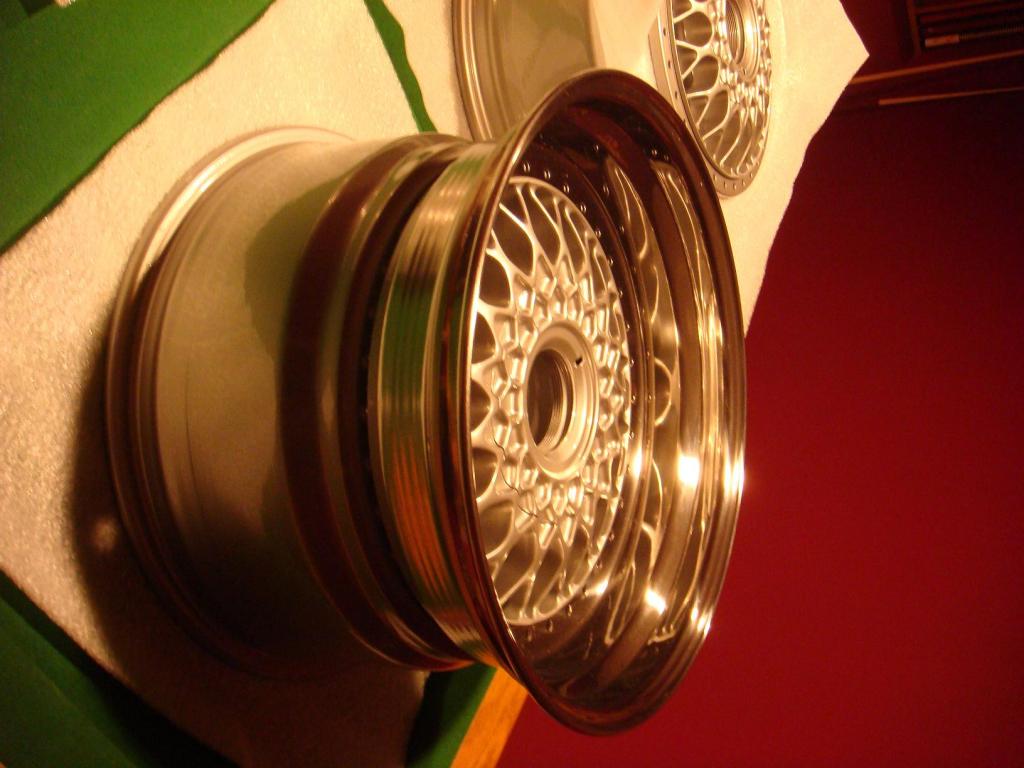

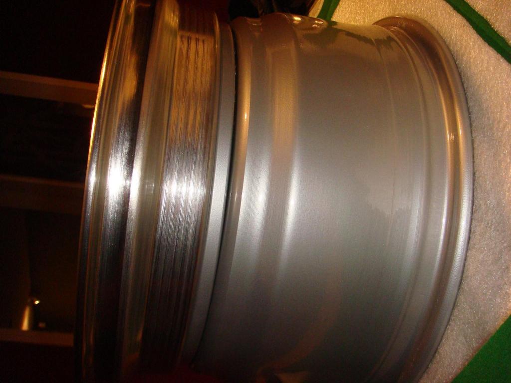

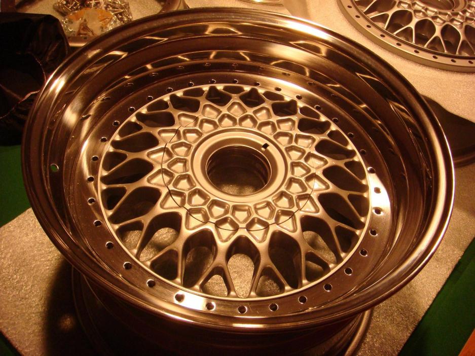

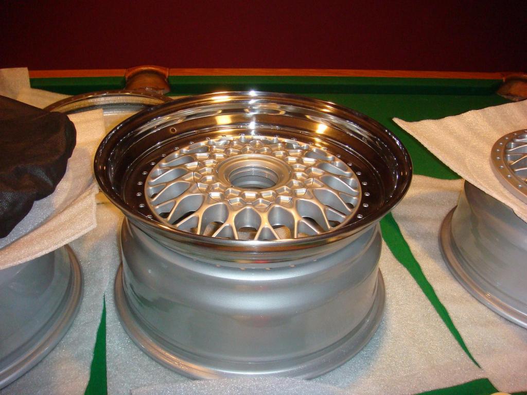

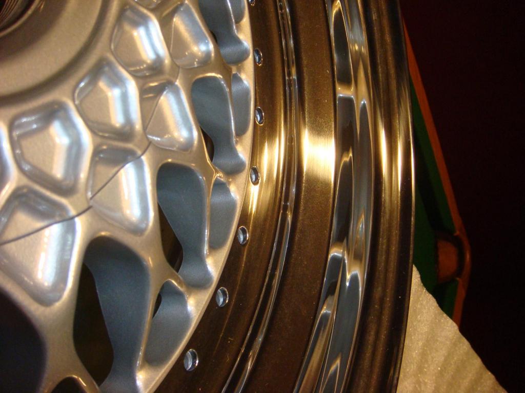

    Started off with a set of high offset BBS RS 5x130 16" wheels with .5" & 1" lips, blasted the barrells and faces and had them powdercoated with brilliant silver with a coat of clear on the second bake.
    I just recieved the faces and barrels back and I am almost complete building up my RS's...
    16x8.5 fronts
    P&P 2 inch stepped stainless steel lips
  • bad_azz_bmr
    • Sep 2004
    • 433

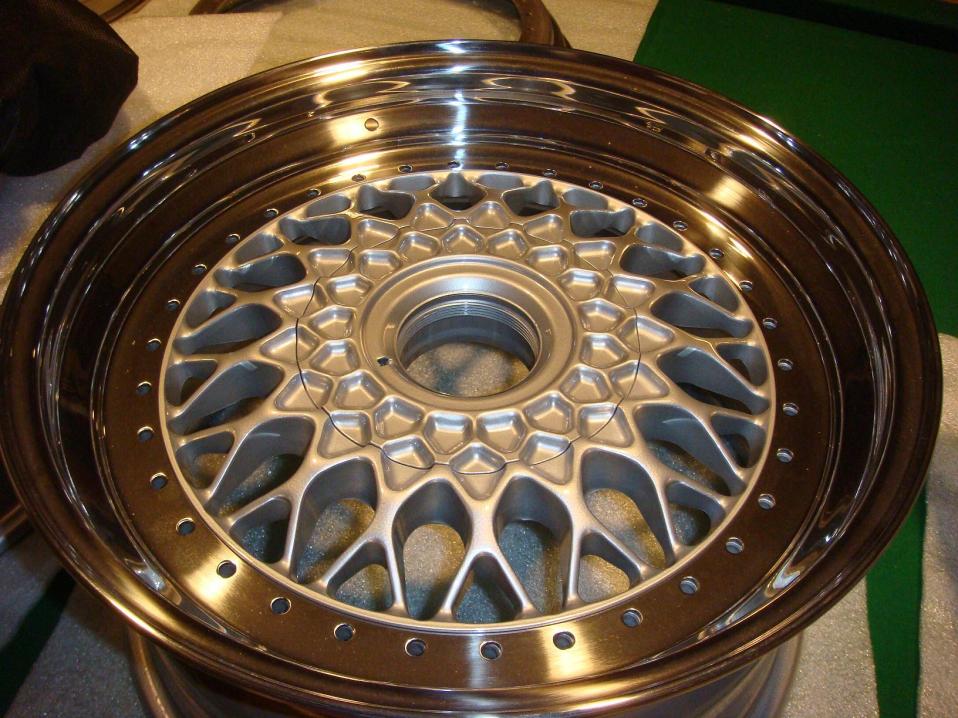

    16x10 rears
    P&P 3 inch stepped stainless steel lips

        Fronts are -20 before adapters and 0 with 20mm FK adapters
        Rears are -7 before adapters and +18 with 25mm H&R adapters
        might swap the adapters front to rear to help readuce some of the rear poke...
        tires will be 215/40 fronts and 245/35 rears..
        alot of fender massaging will be happening, no flares.

                I think its another way around. If the original offset is -20.. You used 20mm spacer up front. It will be -40 offset, not zero. Rear will be -22. Shaving mounting pad or narrower barrels is one of the way to increased the offset (+). Unless original offset is 0, then you use 20mm spacer then -20.

                  sorry i mixed up my positive and negatives, thanks for pointing that out...
                  corrected version:
                  Fronts are +20 before adapters and 0 with 20mm FK adapters
                  Rears are +7 before adapters and -18 with 25mm H&R adapters
                  or if i swap the adapters:
                  Fronts are +20 before adapters and -5 with 25mm H&R adapters
                  Rears are +7 before adapters and -13 with 20mm FK adapters

                    acutally totally messed that up my wheels started off with et49 not et57 as i thought, these will be my offsets:
                    Fronts are +12 before adapters and -8 with 20mm FK adapters
                    Rears are -1 before adapters and -26 with 25mm H&R adapters
                    Fronts are +12 before adapters and -13 with 25mm H&R adapters
                    Rears are -1 before adapters and -21 with 20mm FK adapters
                    • bad_azz_bmr
                      • Sep 2004
                      • 433
                      fronts on this car are 16x9.5 with et0
                      mine will sit identical to that if i go with the 25mm H&R in the front
                      or will sit in 5mm if i go with the FK 20mm in the front

                        Good luck fitting those rears, that offset should stick out like 2 inches.

                            purchased a set of 15mm adapters front and rear and looks like my final offsets are now:
                            fronts - 16x8.5 et16 w/ 205/45/16 KDW2
                            rears - 16x10 et10 w/ 225/45/16 KDW2
                            hopefully should have the tires in a week and some pics posted of the wheels mounted in 2 weeks...
                            I did a test fit with the new adapters and rears are about an inch outside of the rear fender, so by the time the tire is stretched and slight pull to the fender it shouldn't have any problems clearing, fronts are only about a 1/4" outside of the fender and again with the mild stretch and fender rolling should be in good shape.
