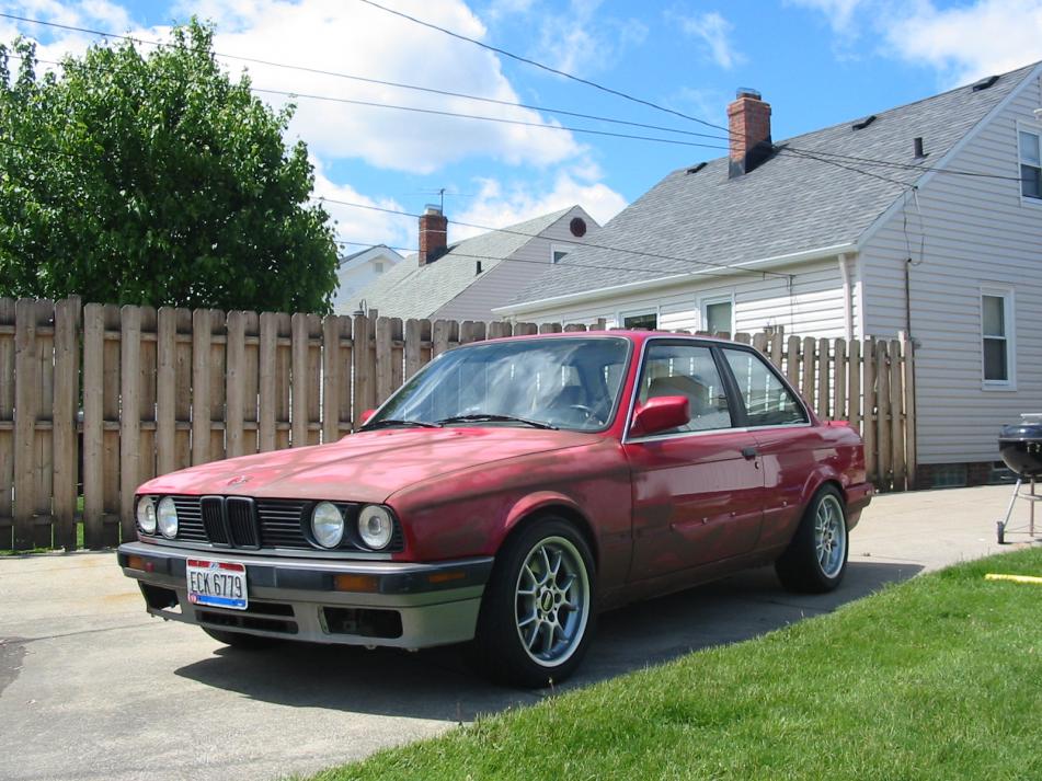

                16" BBS Rk's with 225/45-17 Yokohama Es-100's (wish they still made these tires)
                I forget the ET on these, ill have to look. Its a set of rims from an E36 though
                fits fine, does rub on big bumps only on the right rear, maybe i need to roll a bit more on that side. also with the 5 lug swap and E36 steering rack I have the fronts rub a tad on full lock, but that will be solved with some rack stops. I guess the e36 racks have more travel than the e30 ones. but its a quicker steering feel, i like it
                next step, PAINT

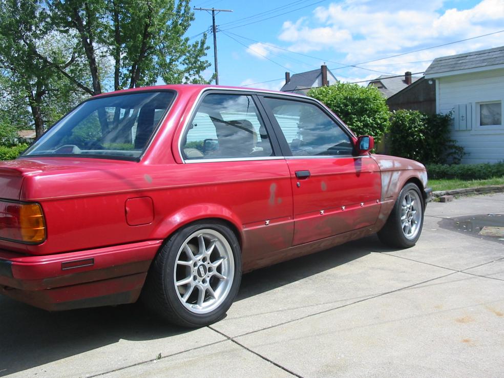

                            16x7.5 with et25 will handle a 225/45/16 tire with no rubbing at all.
                            Here is proof.
