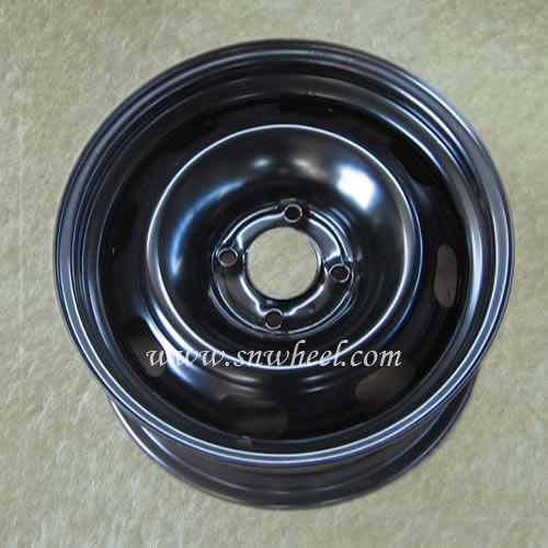

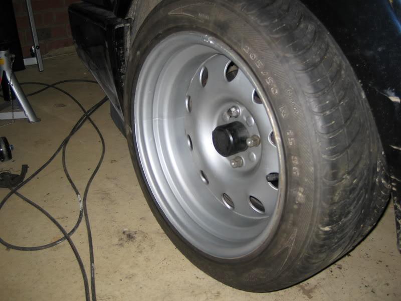

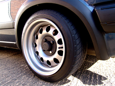

    Examples of what I would like, or use..
