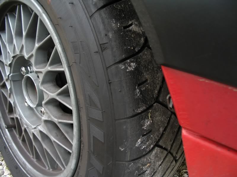

                      meh. Walmart has cans of paint for like $2.50 each, and the same for clear coat. That's under $10 if you get some Acetone too.
                      here is Langsten's write up I used:
                      Green non-metalic scotch brite pad, with castrol power clean.
                      each wheel took ~20 mins, rinse fully, wipe down with Acetone while wearing Latex gloves.
                      spray.
                      dry.
                      clear (if you want to spend the $$)
                      The color I chose, wanted dark silver or grey, turned out to be "gunmetal" to everyone else and I like it. Strange thing is, it is nearly identical to primer. Funny.
                      But even covered in dust, they don't look much different. The wheel remains lighter than the tire (which make black wheels look ghetto....) and you don't have to clean them. I still haven't since the HPDE.

                          The prep Chris recommended worked really well. The Scotch pads were great.
                          Duplicolor....I just don't like the color for some reason. But looks good on Dave's because of the silver lip, just look stupid/like butt on Matt's.
