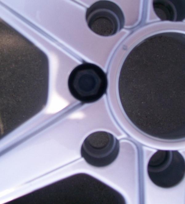

                            Well, I bought some sportmax 501, so I thought I'd share this pic of how our stock e30 lugs fit into the bolt holes.
                            As you can see, it is pretty close, and with a 17mm socket it will fit. However, unless the socket is very tall, you may need an adapter so you can fit your socket wrench properly to tighten them. (My socket wrench is pretty short in length, but the end of it still touches the lip of the rim when I want to tighten them)
