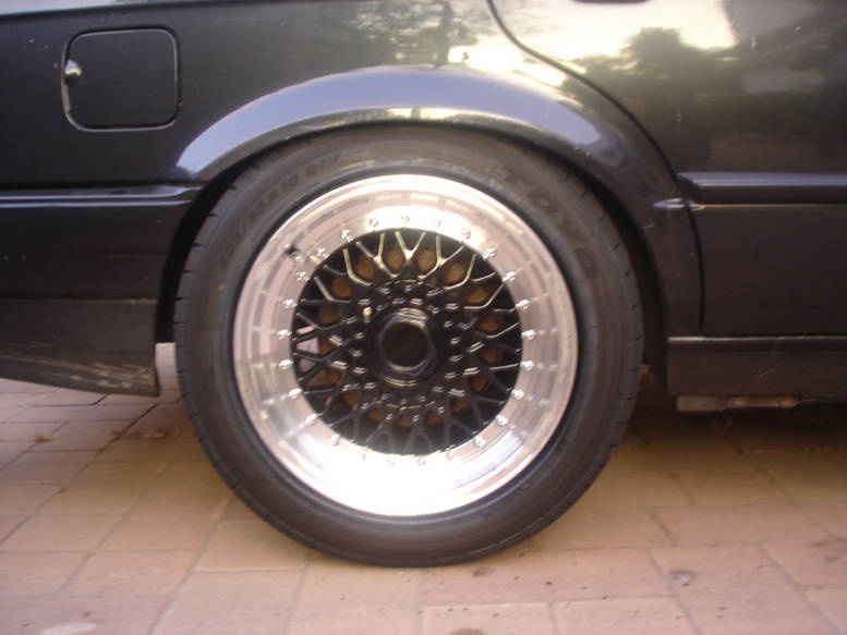

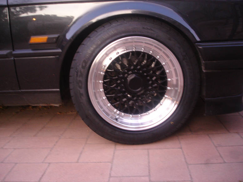

                              pics are not as nice as i expected - light was pretty dim when i came out
                              i hope you can see there -
                              in the rear the tire got nice grind and the front looks very crowded...
