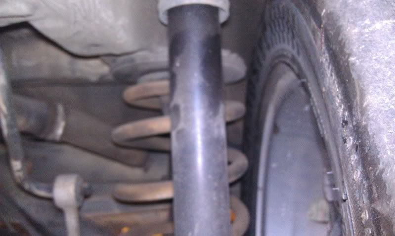

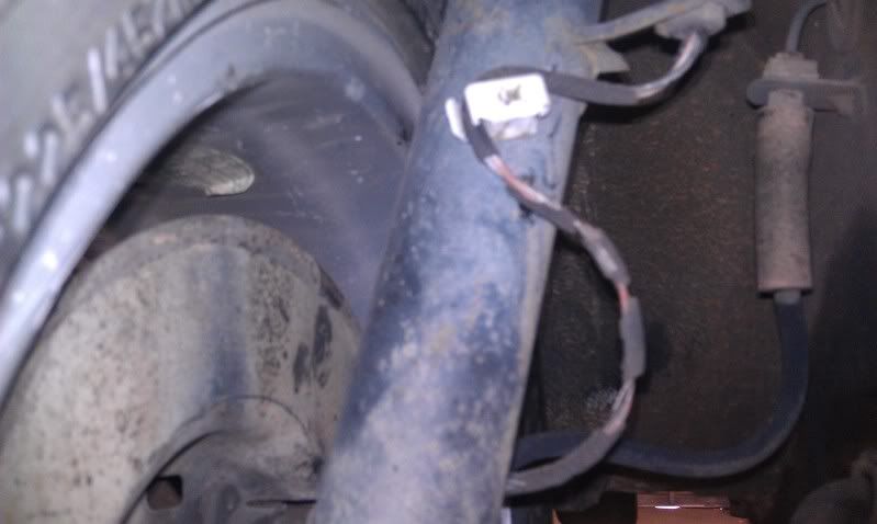

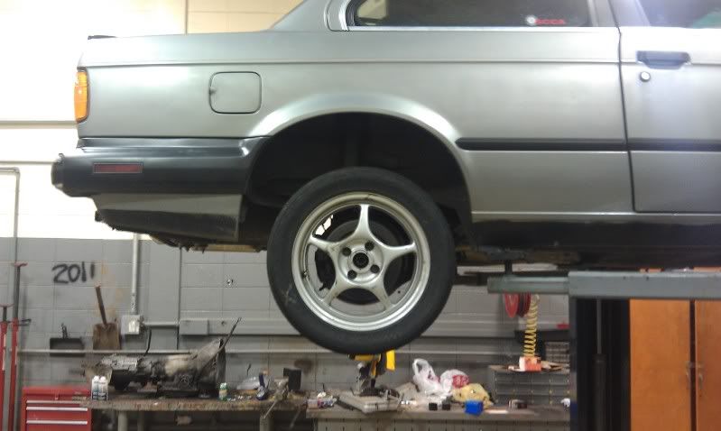

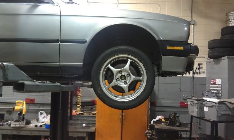

    I acquired a set of Enkei's that were from a Miata. 15x7 et 35 are the specs. I am planning on running 225's on the car and it will be getting sport lowering springs soon. Fronts hit the strut and rears "barely" clear, anyone like to give me some guidance on what size spacers I need to get? TIA
    marks on the rims are from cones, going to try and get those off this weekend.

    Fronts should clear w/ 5mm and that gives you some extra room, but it all depends on how bad they're running. If the rears are barely touching you could probably get away w/ 3mm's. Just my 2 cents.

      I'd personally do 10mm's. The offset should be more in the +20's for inside clearance. That would ease your mind about hitting anything inside.

            Im running 15x7's et25 with 225/50's so a 10mm spacer in my opinion would be perfect! Might rub a little on the front plastic. I just took mine off :D
