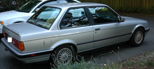

                            I don't have any recent pics of the car with the Hankook R-S3 tires. At the moment my E30 is at a shop getting a motor swap done to it so I can't take any pics. Here are some older shots of it with Falken Azenis RT-615 tires (which is also a great tire but not as good in the wet as the R-S3's.) I'll post current pics of it once I get it back in about a week. However I wouldn't recommend any of these tires for super cold weather and snow.
