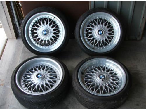

    So i just got a pretty amazing deal from a fellow e30 owner in albuquerque, NM. 17" style fives with new 215/ 40 /17 4 dunlop tires on each wheel for 700 shipped. They seem to be in good condition, no bends, minor curbage etc.
    I apologize for being a complete noob when it comes to wheels with their offsets, center bore etc. and obviously these are a 5 lug wheel. What are my options for mounting these on my car and having them look right?
    Taking the offset into consideration (which keep in mind I know nothing about and blame the ADD i think i have for not being able to understand offset) would adapters be applicable in this situation? or would I have to resort to drill n' fill.
    Thanks homies

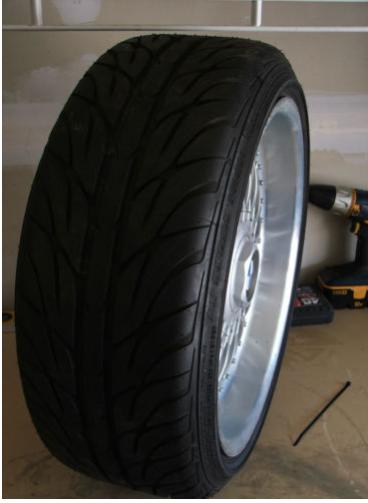

                  How wide are your wheels? And could you post the side profile view so I can see how the tires fit? I'm still trying to decide on what sizes to run on my 17x8 and 17x9.

                    Originally posted by e30slidewayz
                    Fill and redrill is the way to go...
                    Those look beautiful, are they yours? if so, how much did you pay for that fill and drill?
                    Mine are 17x8
                    • e30slidewayz
                      • 813
                      damn, i'm definately going with 215/40 in the front. nice deal you got there.

                        what series dunlops are those?
                        • navid41691
                          • Apr 2011
                          • 677
                          I'll find out in a little bit. But are those your wheels? how much did you pay for the fill and drill?
                          • e30slidewayz
                            • 813
                            They are mine, I bought them from someone on the forum, ElCaminoLV. He did the work to them before I bought um. He's in Germany I think, so pricing would be different. I paid quite a bit more for them than what you paid lol.
                            • navid41691
                              • Apr 2011
                              • 677
                              Yeah with a re-drill that professional looking i'd expect to pay a lot for them too.
                              The tires are Dunlop sp sport fm901 tires
