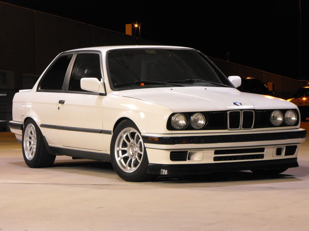

                  I've been running the Khumo Ecsta AST in 225/50r15 on the TRM C1 15x8s. They are cheap like 77 each and are pretty decent for DD duty and ok in the autox track. I had to roll my rears because the rear fender lips were literally sitting on the tires, no spacers. I am running IE3s with spring pads and e90 top hats w/ spring pads. No issues up front unless tight uturns with elevation change I may rub, but all fenders are now rolled. No rubbing issues now in the rear. I am a M42 if that makes any difference.
                  this was with most of the interior out of the car and an empty trunk, as to why it is sitting up high in the back.
                  This was before the top hats, front euro trim, oem lip, new hood, euro plate and fogs so please don't mind how bad it looks.
