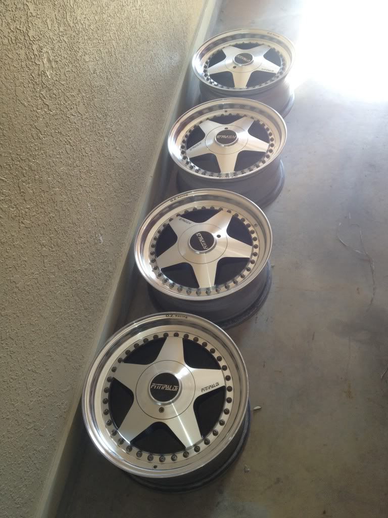

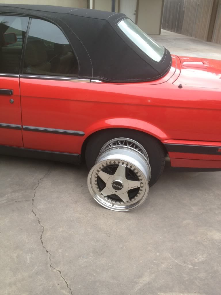

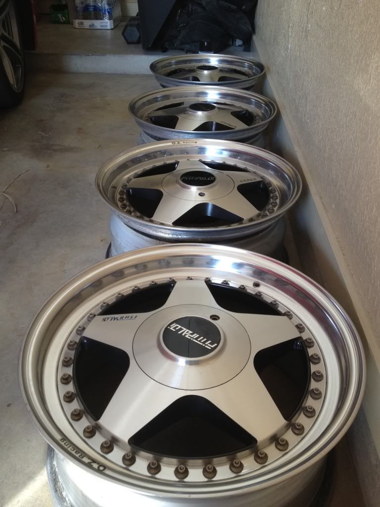

    Hey guys i just bought some 16x8.25 et 25 fittistars 3 piece wheels and i need some opinions on which tires i should get as well as which spacers i should get so it can sit flush. Here are some pics of the wheels. I don't want to get some really skinny tires since i don't want a wheel gap and btw i have vogtland springs and just ordered some Bilstein sport shocks. :D

                As far as figuring out what spacers to run, just mount the wheel on the car then measure from the fender lip to the wheel with a ruler. That is how thick of a spacer you need.
