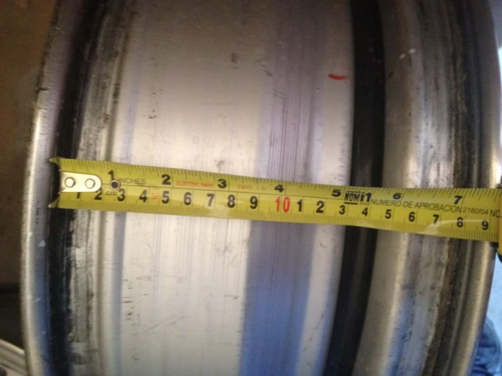

    Am u the only one who thinks 8.25" looks funny?? OP, measure again, and this time don't measure from outside lip to outside lip.
    Also, never have I seen a 4x100 set of these. can you take the covers off and snap some pics?

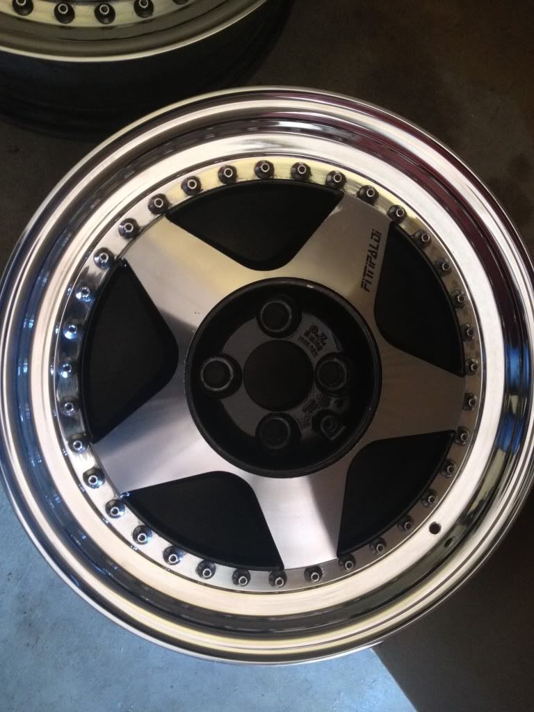

      I say they're 16x7.5. I still need to see the PCD though. I smell a redrill or some misinformation.

        Here you go legit 4x100!!! And yes they are 7.5 does this mean i need smaller tires? i was thinking of putting 205s and later on i do plan on getting bigger lips :pimp:
        First wheel im almost done refinishing i took off the clear coat,repainted the black, polished the lips and all i have left to do is clean out the bolts a bit more. i was thinking of polishing the face but im not sure yet.

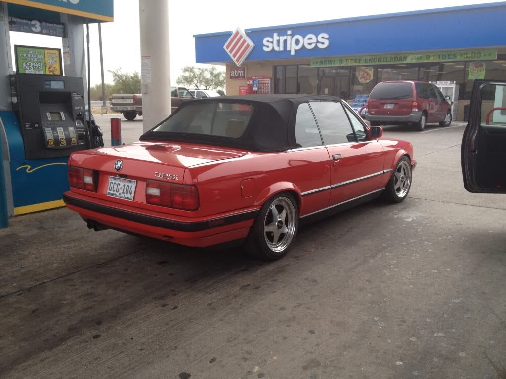

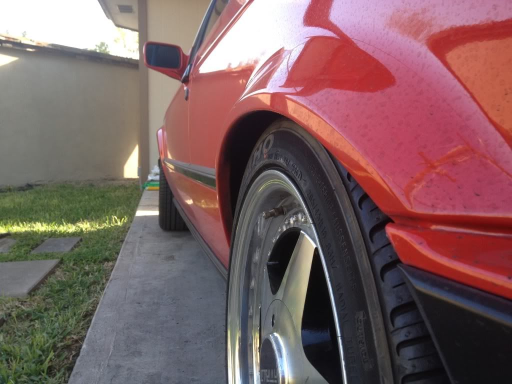

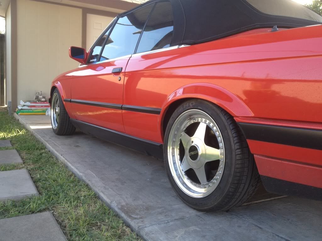

          In that case you'll want 20mm spacers in the front and 35mm spacers in the rear with 205/45's. That should get you flush. My fronts are 16x7.5 final et 5 with full camber up front. And you can run any BBK you want with those spacers in.

            Some pics of the wheels on the car
            I am thinking of 17mm spacers or should i just go with 20mm??
