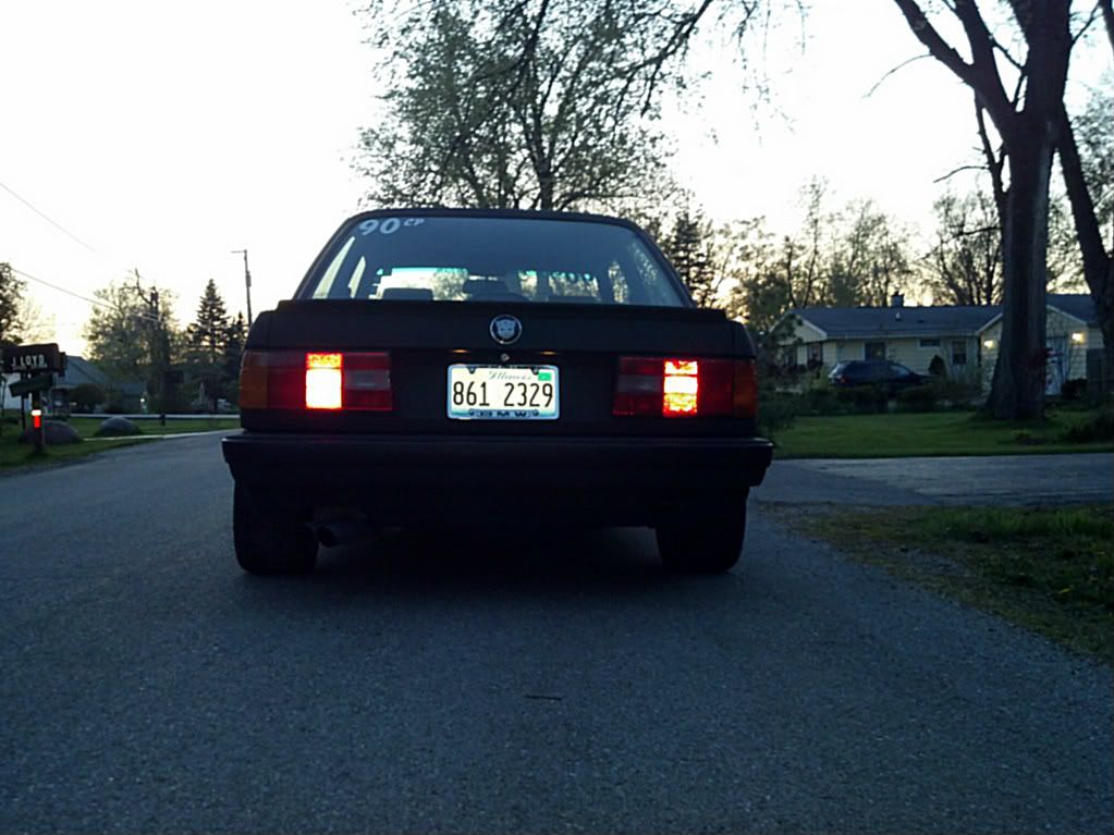

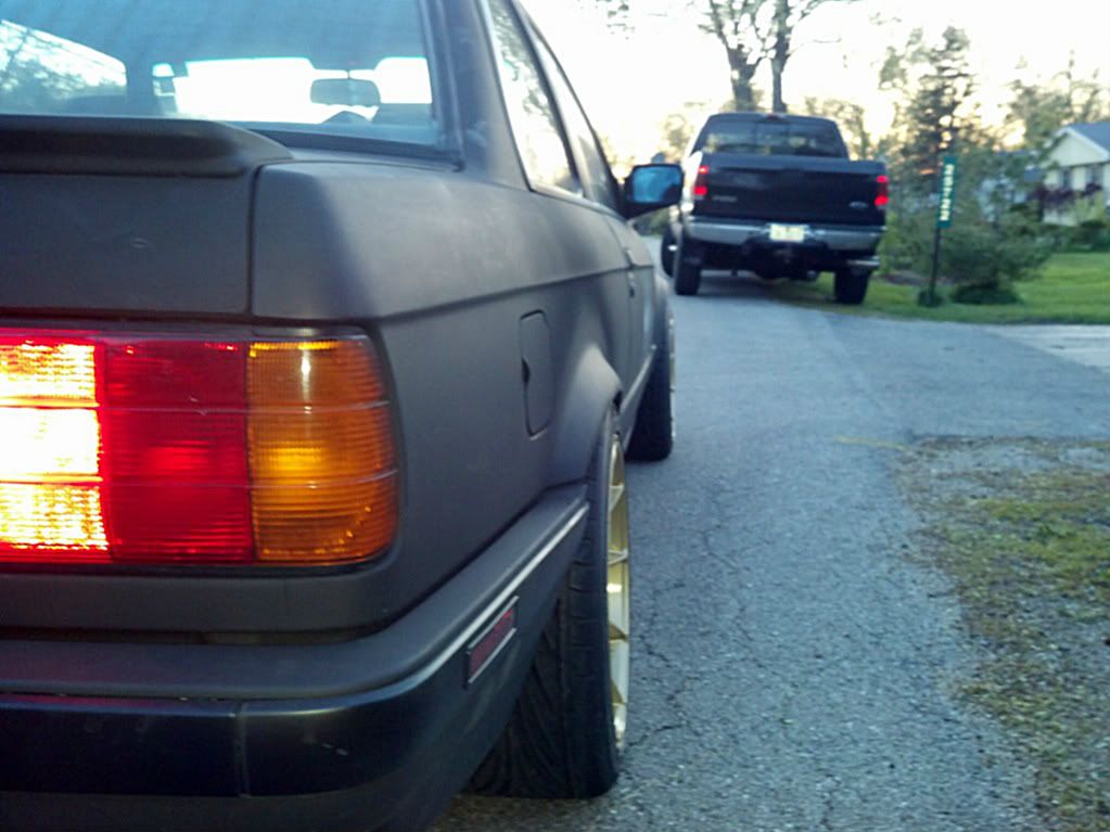

      I'm looking for some rear pics of these to see how wide a 8.25 tire looks on an e30.
      Also, I'm planning on getting these and have 25mm spacers.. Would these fit with the spacers and moderately stretched tires with just rolled fenders? It is just on an eibach pro kit no camber plates

        best I've got. No way you will run these with spaces. et0, took tons of fender work to fit.

          So i have to roll/pull the fenders even without spacers to run these et 0 wheels?
          I am debating doing a wider rear fender to fit them with 25mm spacers.. My drivers rear arch is rusted and have to redue it anyways, so why not try something new?

            I had to roll/pull the fronts, and roll/pull and cut the inner fender liner back about 5" to clear the rears and they still rub under full suspension compression. I'm also running an undersized tire at 245/35/16 in the rear. Suspension is J-Stock.
