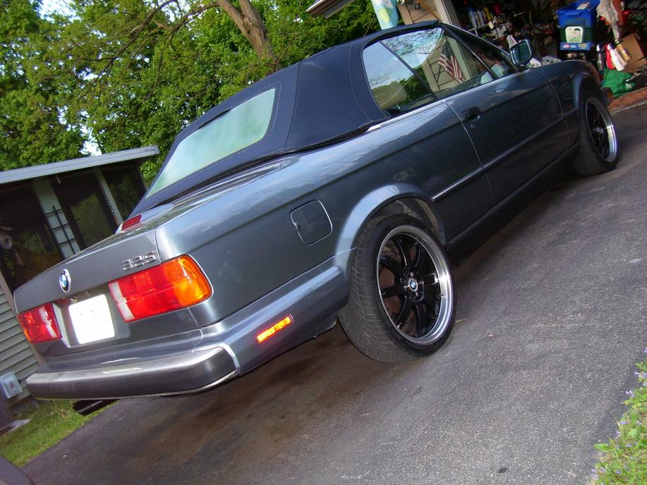

    Got these from my neighbors 90's Civic, 17 in Konigs with 225 40 mismatched rubber.... Went down the road to try them out after swapping them on and started getting serious looseness and got back home to check it out and ended up with 1 lug out of the 4 left holding the left front rim on (just barely)..... one lug got stripped, retightened all 4 wheels as they all got loose, took it less than 1/4 mile down the road and could hear and feel them loosening again, I used my stock BMW lugs and no spacers, what do I need to do to get them to stay on the car.... Thanks

      What are you torquing them to? needs to be 85-90'ish lb/ft I believe.

        Are those even hubcentric/do you have hubcentric rings? Most Honda 4-lugs are 56.1mm centerbore, E30 is 57.1mm. And are the OEM lug bolts long enough? Could be that the wheel is too thick and you not getting enough threads into the hub.
                Had not torqued them will give that a try...
                Lugs seem to go in their full depth, the wheel is not too thick at the hub...

                    I tightened them with my torque wrench and they are secure now, thanks to those that know how to offer assistance with out being an ass....^^

                      Oem lugs generally have a different taper than aftermarket wheels. Determine if your lugs are conical or ball, and then check the wheel, your most likely mismatched and the wheels will possibly work themselves loose again.

                        You should recheck them after a ride. It sounds like you might need hub center rings, even with the recent torqued bolts.
                        Here is a good way to check: if you can put your rim on your hub (lugbolts removed) and wiggle your rim, even a little bit, then you need a centering ring. Any amount of play will eventually walk the lugbolts right out.
                        Also, make sure you are using the proper lugbolts with the appropriate taper.
                          Think they are both conical but not 100%, will verify that...
                          No, they are not hub centric for sure, didn't realize this may walk them off again.... Thank you both for that info, much appreciated...
