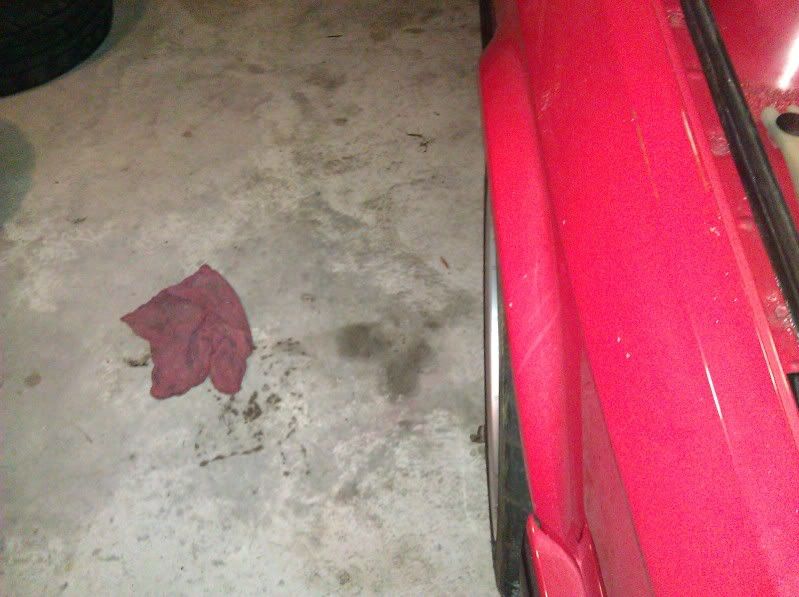

                  you need et41 (e36m3) wheels and there are a ton of options in the 17's.
                  Just not that many 16" wheels make it over the e36m calipers. I ran 245/40's on mine and liked it. I also had a VERY adjustable susp.
                  see sig for pics
                  Edit:
                  Here is the e36m3 staggered rear wheels
                  Normal DS2's
