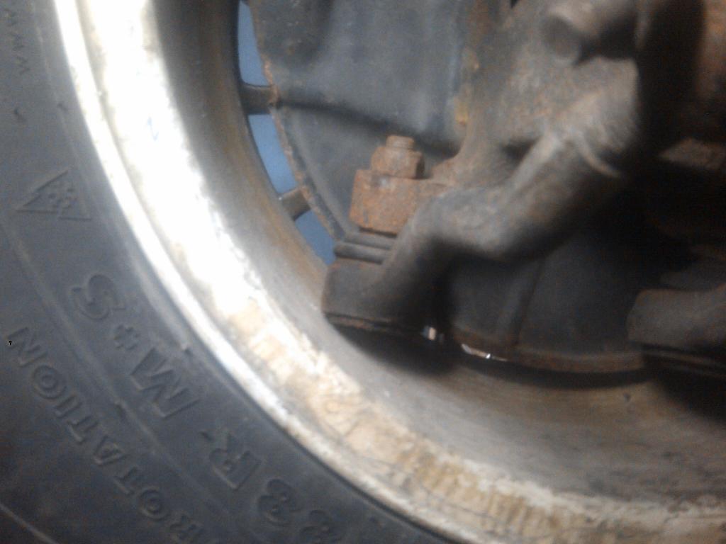

    I am having trouble comprehending this, so maybe you can help. my winter set of wheels (bottlecaps) only fits with certain wheels on the front, due to rubbing on the tie rod ends.
    This winter, the same wheels I ran last winter (driver side front) now rubs on the tie rod end, leaving a streak down the rim where the two touch (occasionally). the repair shop next door is staring at the 1-2mm of clearance on the passenger front in disbelief saying they've never seen a tie rod end so close to a wheel. and to be honest neither have I.
    WTH is going on? my summer tires are on weaves (6.5" width), and they don't have problems - I even bought newer b'caps in better shape and they still rub.

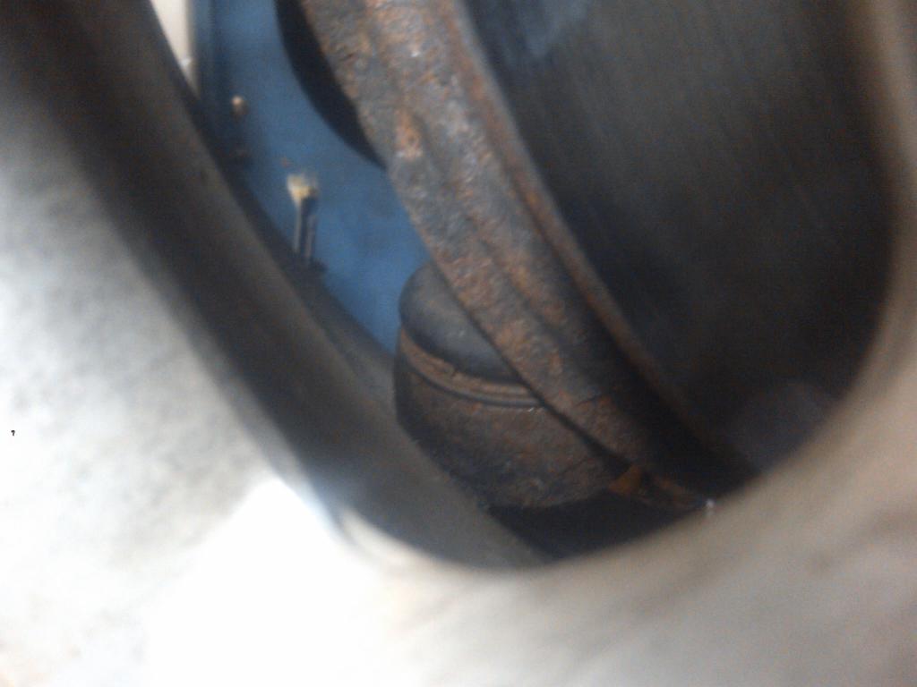

      If you're telling me the end of the front strut is bent, that's a lot of very thick steel to bend with virtually no force on it to bend it.
      I know not all the wheels are perfect, but that still doesn't account for a wheel fitting on one side and not the other.
      side that doesn't rub (PS):
      side that rubs (DS):
      it's a bad angle I know - looks like it's eating it because of the shape of the wheel, but it's deceiving.

            Tie rod is not loose.
            Anyone with bottlecaps that fit willing to throw up a pic like the first one? I want to see how much clearance there should be.
