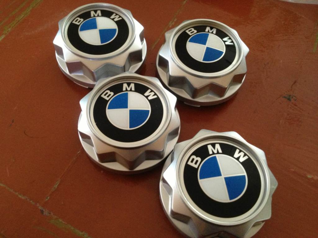

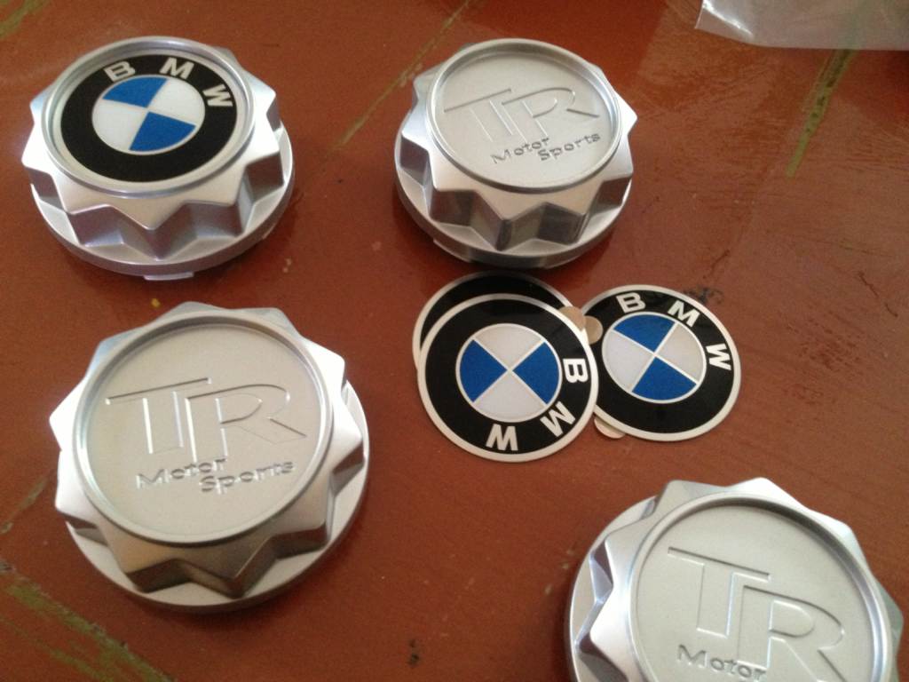

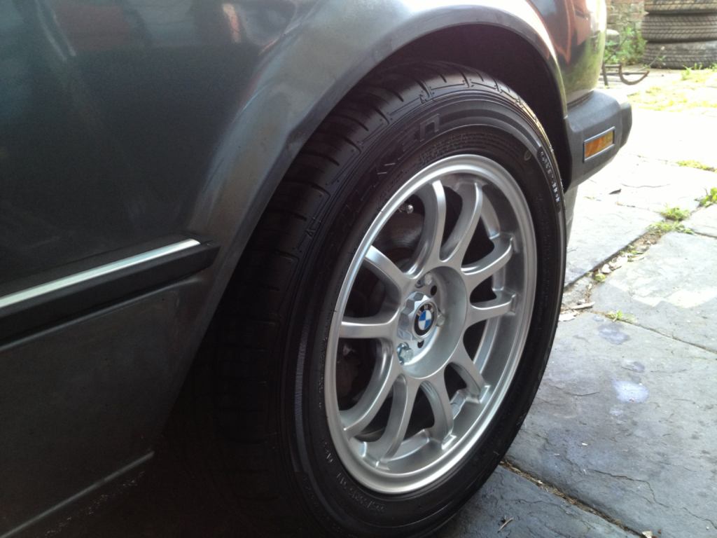

              So, the center caps for the C3M wheels arrived today, and they fit the wheels perfectly before putting the wheels on the car. Once the wheels are installed, the caps still fit on the front wheels, but the hub of the rear wheels stick out too far to allow the cap's tabs to seat correctly in the wheel.
              I measured the tabs on the center caps, they need about 3mm to securely attach to the wheel. A 4 or 5mm spacer would probably allow the caps to attach to the wheels in the rear.
              I drive an 86 325e. I'm unsure if the hubs are the same in all models, but if yours is set up like mine, you will likely be in the same situation. I am planning on getting small spacers for the rear anyway to get the wheel out a little further. This will also allow me to use the center caps. Now, I need to find some roundel stickers to put on the caps.
              • itique
                • Jan 2013
                • 23
                I've now got the caps fitting on all 4 wheels. I put 5mm spacers on the rear wheels and they now fit. Click image for larger version
