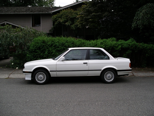

                        Now that I am home from work. Here is a pic of my car running THR CABs with stock suspension.

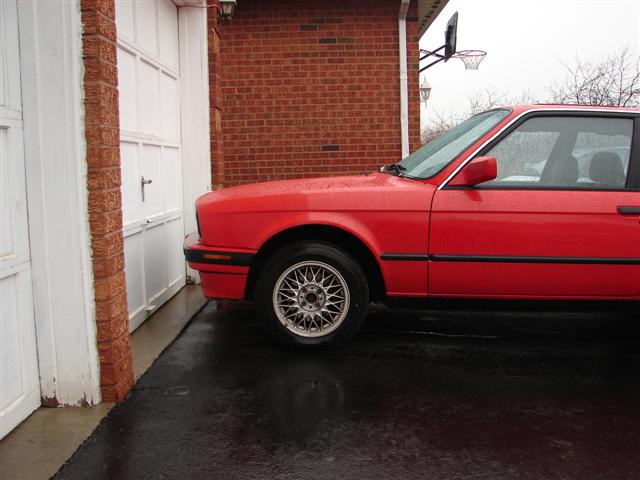

                          alright...heres pictures. don't mind the dirtiness.
                          you can see that they are both pushed forwards a bit.
                          wouldn't adjustment of the caster set the wheels like that?
                          i always thought that thats what caster did. change the angle of the suspension and since the strut can't move at the top then the bottom would have to be pushed forward. right?
                          btw these are the "summer" tires i have on.
                          • DarkWing6
                            • Apr 2004
                            • 7144
                            Find out what that tech adjusted becasue apparently that is what screwed it up. The only thing you can adjust with an alignment is the toe. I don't know how he adjusted anything else, but you should try to find out.
                            • nando
                              • 34839
                              he couldn't have adjusted castor. you don't have camber plates do you? and THR/offset cabs give you more castor, that's the whole point.
