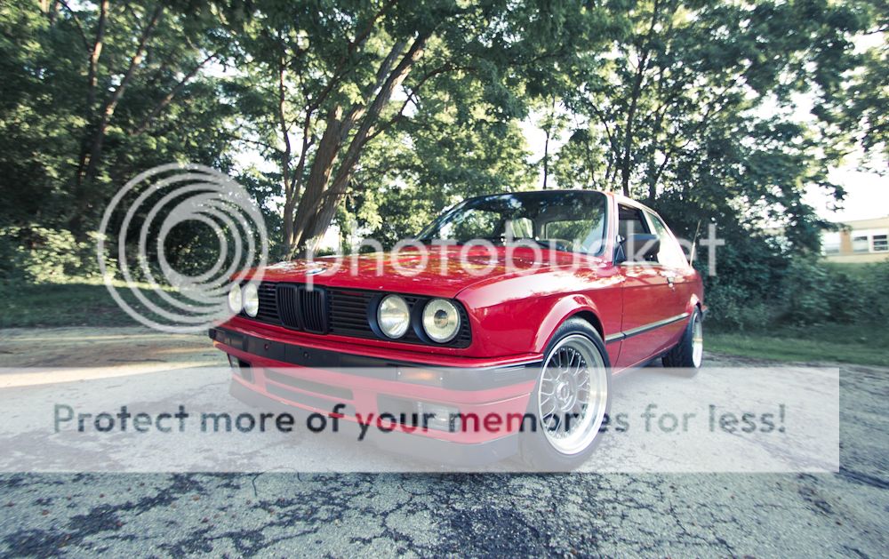

          I was running the same wheel (not ESM, but same specs) Yes, rubbed the outer sidewall.
          Best reference shot I could find
