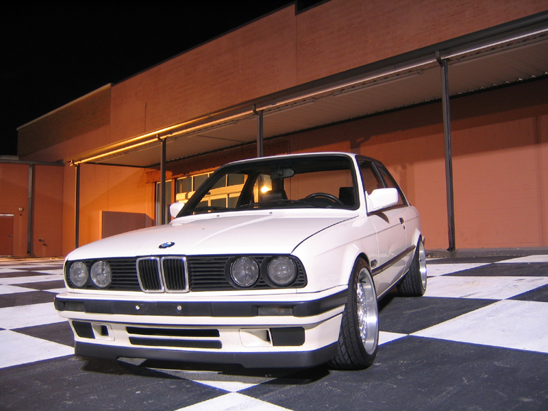

            the M3 fenders arent really wider, just the wheel well goes up further. from the outer edge of the wheelwell on the norm. E30, the M3 goes straight up.
            so if the car isnt really low, you should have no problems.
            here is a pic of a 18" RS with M3 rear suspension, on a normal E30. yes the tires are euro gayness stretched, but you know you want em.
            • RCWells
              • 3589
              LOL, not so much.
              Are you seriously saying the fenders are not wider on the M3? ??? I don't get that. Explain again please.
              My car does sit pretty low actually, I'm on H&R Race. I wouldn't say it's slammed, but it IS low. My offset on the Kopis is 20mm and they sit pretty damn close to the outer edge of the body. There is a bit of play maybe, but not much. I am just not sure if the 11mm will push them on out. Also, IF I did the lip swap and made them another .5in to 1in. wider, what does that do to the offset? It should make it that much lower, right?
