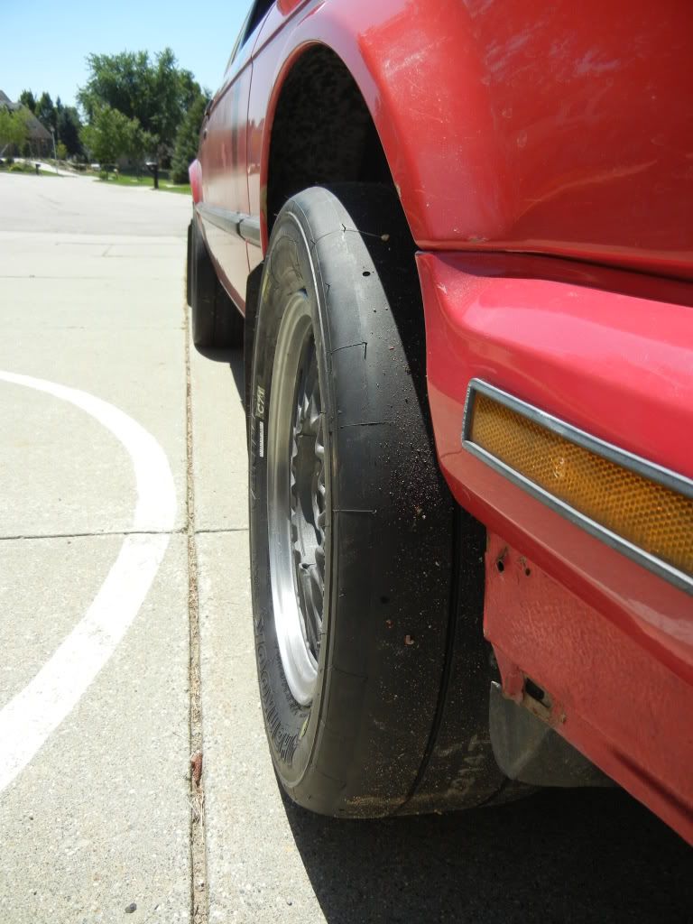

    They definitely are, I believe the tread width is something like 7.7 in. They fit great up front though.
    I can't tell from the mounted picture, but are these on stock basketweaves? I am under the impression that the largest tire I can run on the basketweaves is 205-60-14 is that correct?

      I once ran 215-60-14s on caps.

              205/60/14 on weaves. Love it. Hate how 195s look.
                        I know this is an alder post, but you can definitely fit wider...
                        225/50/14 R-comps :P
                        • frolf
                          • Nov 2005
                          • 191
                          #297
                          They are 225/45-16 mounted on e38 filled and drilled style 5s.
