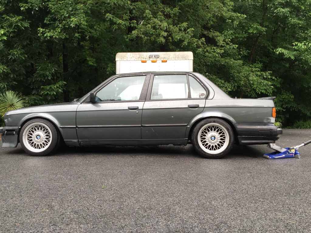

    You're not fitting more than a 205/45 in the rear with late arches. I have my arches pushed out as far as they will go, and a little further ( :( ) and there is still some rubbing. I'm on full poly bushings in the rear so it's not the subframe moving around.
    This is GCs with race plates up front. As low as the car can go without sectioning the front strut housing and leaving the collar in the rear. I now have the collars in the rear out so it's lower than this.

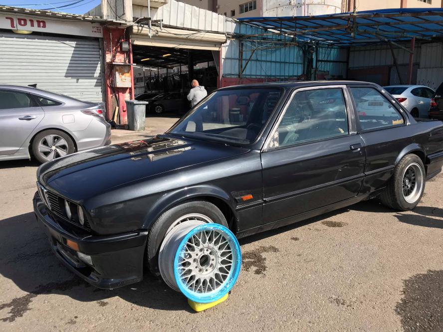

                          sorry for bump, but I have the same question with a small change.
                          I have 87' 325i and I bought style 5 e38 wheels.
                          I make a 5 lug conversion with a e36 hubs, what is mean that the offset change by 12mm (negative).
                          So I want to fit this style 5 e38 wheels with 225/45/16. the offset will be ET11 at front (after the hub adapters) and the width is 8".
                          It will still rubbing? I was make a little fender rolled on the fenders front and back.
                          car is lowerd by IE stage 3 springs with koni sport shocks. I have a spring pad now (9+3) and thinking to change to 3+3 and e90 drop hats if possible.
                          Thanks and sorry again!
