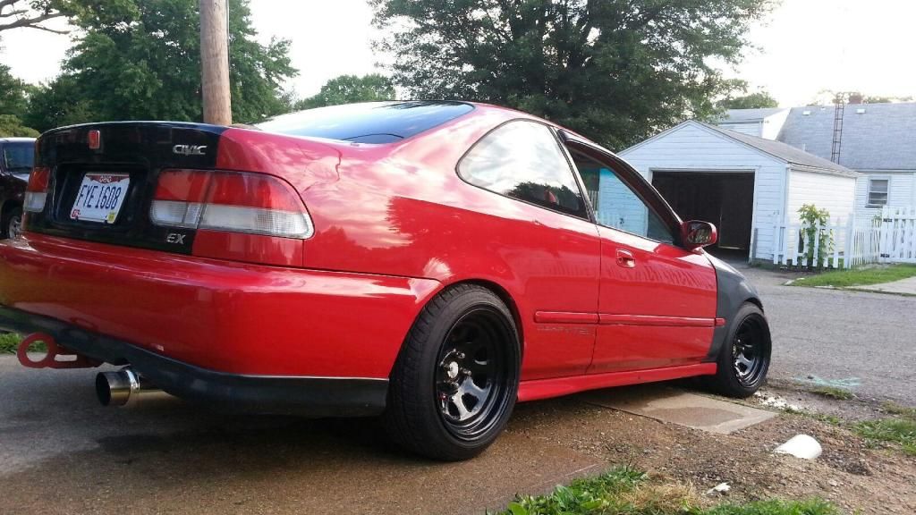

    Thinking of buying some diamond racing wheels off craigslist. they are 15x8 with 0 offset and 195/50/15s on them! do you guys think they will fit? I'm on eibach springs!
    [IMG][/IMG]

    They'll fit with a roll. One thing to watch out for with DR Steelies is that, iirc, they are not hubcentric so you'll have to center them with the lugs.

      its gonna be mad pokey poke.

        Decided i might just go with some new ones since there wouldn't be much price difference then i could get what i want! I'd like 16x8s and i'm just wondering what the best offset would be?

          They will not clear your brake caliper brackets unless you grind the caliper bracket off or run atleast a 12mm spacer.
