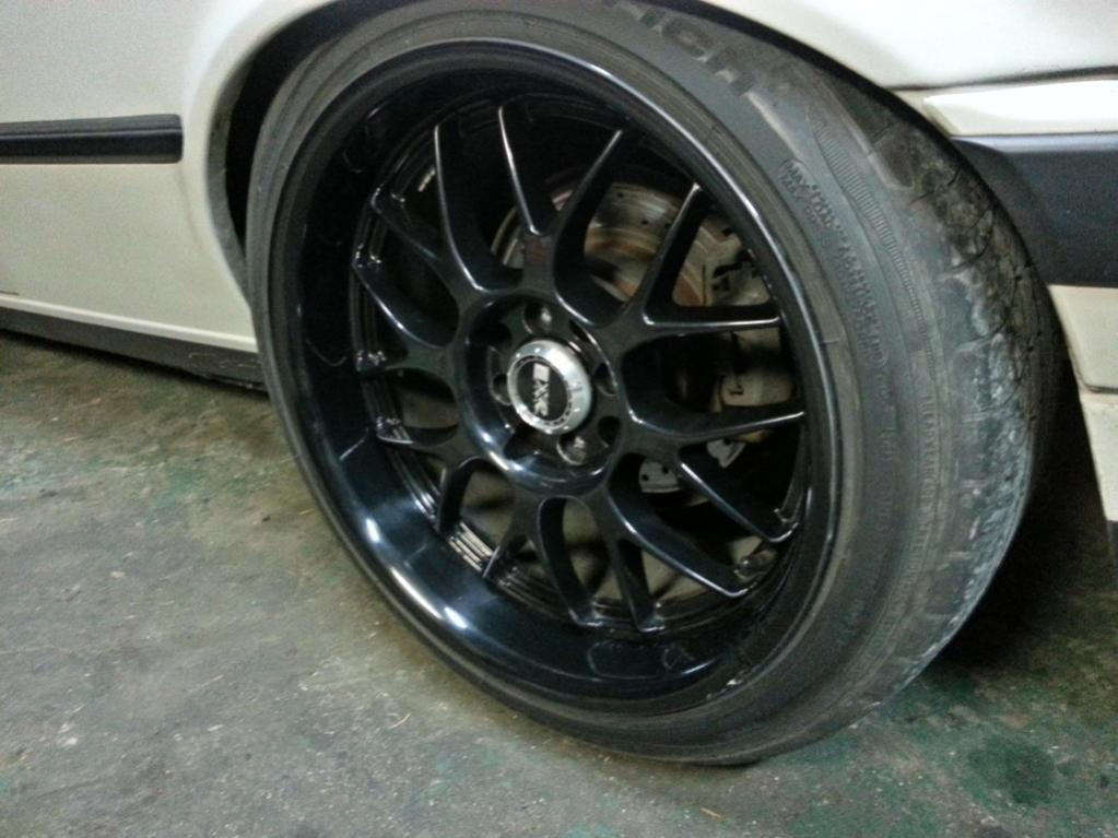

                    From what i calculated with that setup you want at a +10. Your wheel will poke out the fender exactly 1/2 in the back and about 1 1/2 in the front with no camber plates. If you have camber plates and put back to stock, you will poke out about 2 inches.

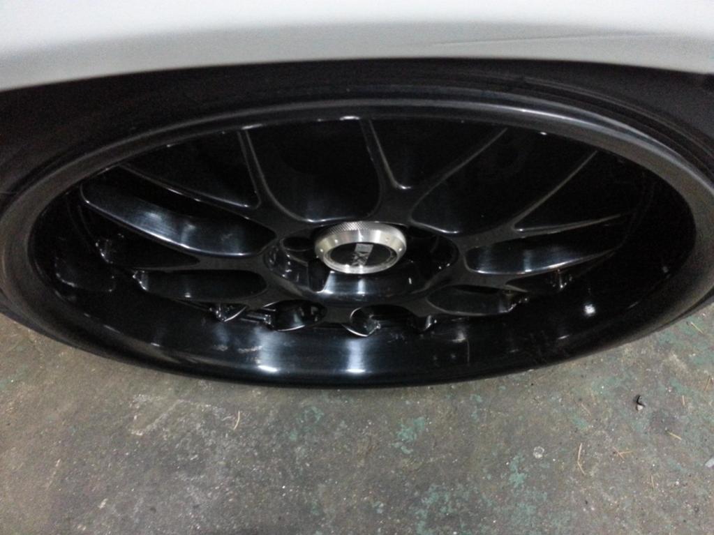

                    Here's a example of 17x9 +20 in the back with no spacer on 215 45. You have exactly 1 finger between tire and fender. All i did was roll the fender slightly. No pull. Here's a shot from the back also.
