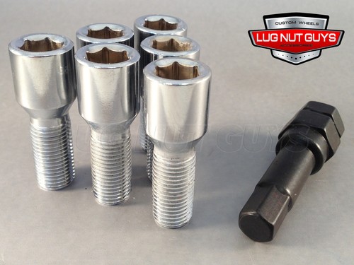

              How about a tuner bolt like this
              www.gecoils.com
