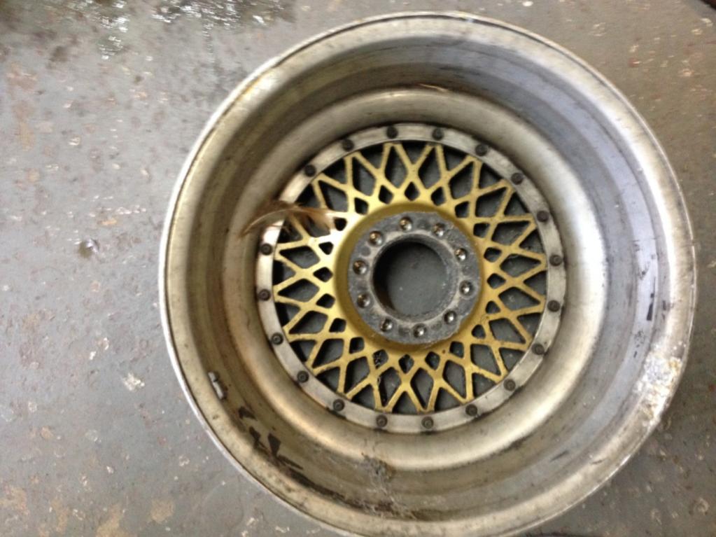

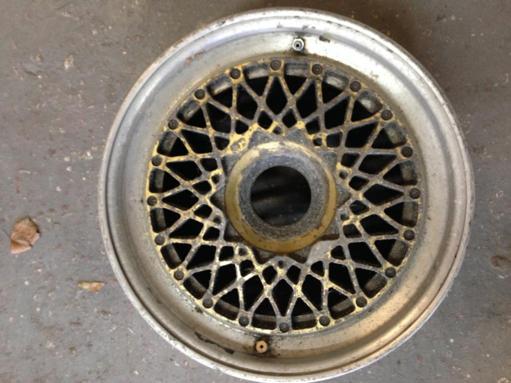

    Hi,
    my name is Jason and I live in the UK, I am after some help identifying these wheels, all I know for sure is they are 8j x 17", BBS, made in germany and have a 10x120mm PCD.
    87 is stamped into the casting, I assume this is year of manufacture.
    They weigh roughly 7.7kg.
    What I think is; they may be BMW fitments and likely have been used on a classic/historic racer at some point later in life.
    I think they may be a BBS E50, alloy outer, mag centre?
    All I would like to do is find out if they are BMW fitments or something else, ultimately I would like to see these back on a car that they belong on, such as a historic racer or parade car, but first I need to ID what they actually are.
    Any help will really be appreciated...

    They are E50's.
    They are centerlock wheels, and have 10 holes in the back to match up to the hub mounts on a DTM/BTCC E30 M3.
    See the below for reference:

        Thanks, I assume they will fit any BMW racer of that era? 635csi, M1, M3?
        • UNHCLL
          • 8790
          No, not an accurate assumption.
          You'll need to do some research on what they cross-over on.
