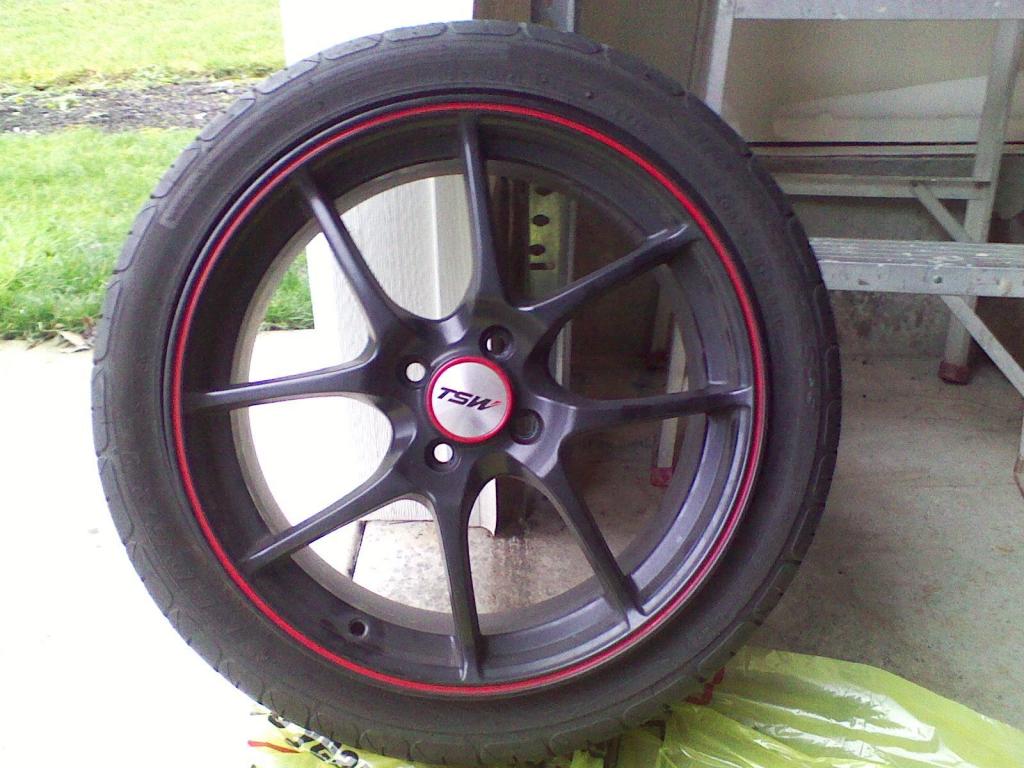

    Would these fit an E30?

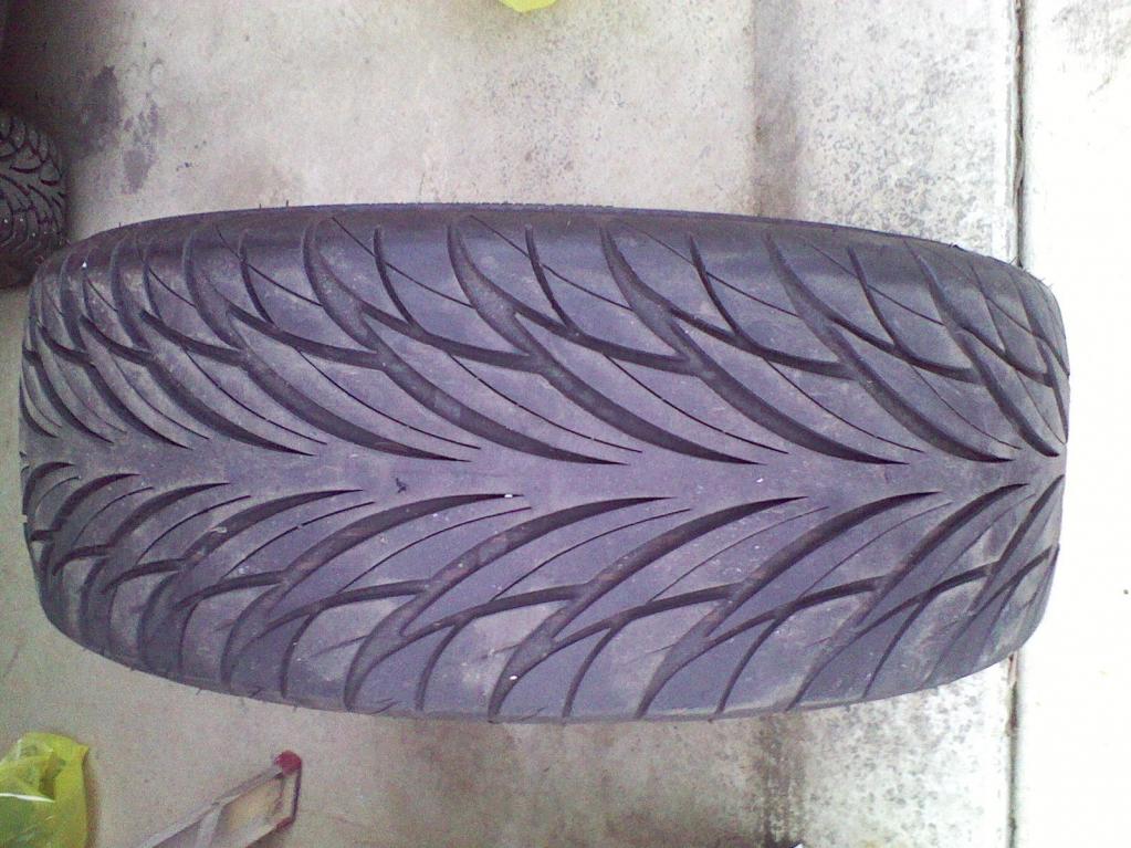

    My girlfriend just removed these wheels and tires from her Mini Cooper. They are 17 X 7 TSW alloys. The tire shop told her they have a high positive offset (40 or 43). The tires are 205/45/17 Federal Super Steel 595's. Would these fit an E30? If so, what is a reasonable asking price? They are in excellent shape and the tires are less than 2 years old with very few miles on them.

    You'd need something in the range of a 15mm spacer....
    t
    • Holland
      • Nov 2008
      • 7212
      A 20mm spacer would be more ideal.
      Originally posted by DEV0 E30
      • E30_fiend
        • Apr 2006
        • 7348
        Hell, I'd go bigger than that. Et20 on a 7 inch wheel is still tucking.
        Also, you will need a spacer that coverts from Mini Cooper centerbore to e30 centerbore.
