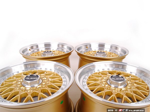

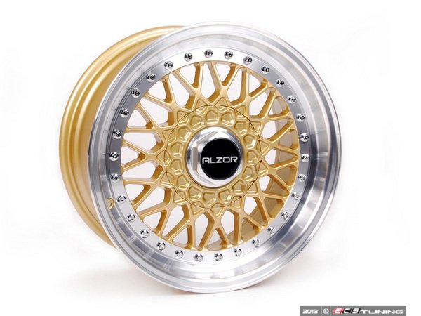

    A friend of mine showed me these wheels the other day:
    ECS Tuning Alzor 010
    16x8" ET20 4x100 57.1CB w/ 1.5" lip @ 19lbs or 16x9" ET12 4x100 57.1CB w/ 2.5" lip @ 20lbs
    http://www.ecstuning.com/BMW-E30-325...market_Alloys/
    Not gonna lie, I'm digging the design and the price tag ($500 for a set of four). They offer them in silver and gold, and in either 16x8" or 16x9"
    What kind of tire options are we talking here (both for a square 16x8 or a staggered 16x8 front, 16x9 rear setup) on a moderately (~30mm/1.25") lowered late-model e30? I don't have particularly stiff springs and would like to avoid a fender roll if possible. A quick calculation showed 225/45 or 205/50 is the closest to the factory wheel+tire height. Anyone with pics of these tire sizes on an e30?
