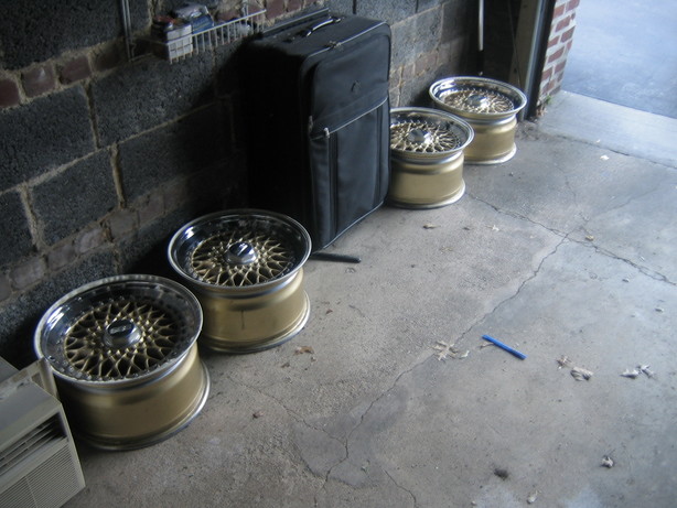

                      Here are the wheels. I am not completely sure on the offset, as the person selling them is not sure on his measurements, but like I said, any input will help.
                      John

                      • Borat
                        • Jan 2005
                        • 494
                        An offset around ET20-25 is ideal, so a 10mm should do the trick.
                        I think you may be mistaken. You are aware that the required offset changes depending on your rim width? ET20-25 is good for an 7-8" rim but you will need around ET15 for 9". Get a 20mm spacer.
                        http://www.1010tires.com/WheelOffsetCalculator.asp
                        A 17x7 rim with ET40 will just clear the strut (45mm). Going by that calculator 16x9 with et15 should give you similar clearance.
                        edited to sound less angry- all good josh

                        • Jand3rson
                          • 37587
                          Originally posted by Borat
                          Please don't give more wheel advice until you know what you are talking about. You are aware that the required offset changes depending on your rim width? ET20-25 is good for an 7-8" rim but you will need around ET15 for 9". Get a 20mm spacer.
                          Alright, so I was mistaken there. I had forgotten the 9" width when I was thinking about the ideal offset. I do know what I'm talking about. There's no need to be such a dick about it.
                          On another note, the offset should be stamped on the wheel face, underneath the centercaps. That's how it is on the stock BBS weaves, that is.
                          • stillflossin15
                            • 90
                            I think i am going to do 25mm spacers front and rear.
