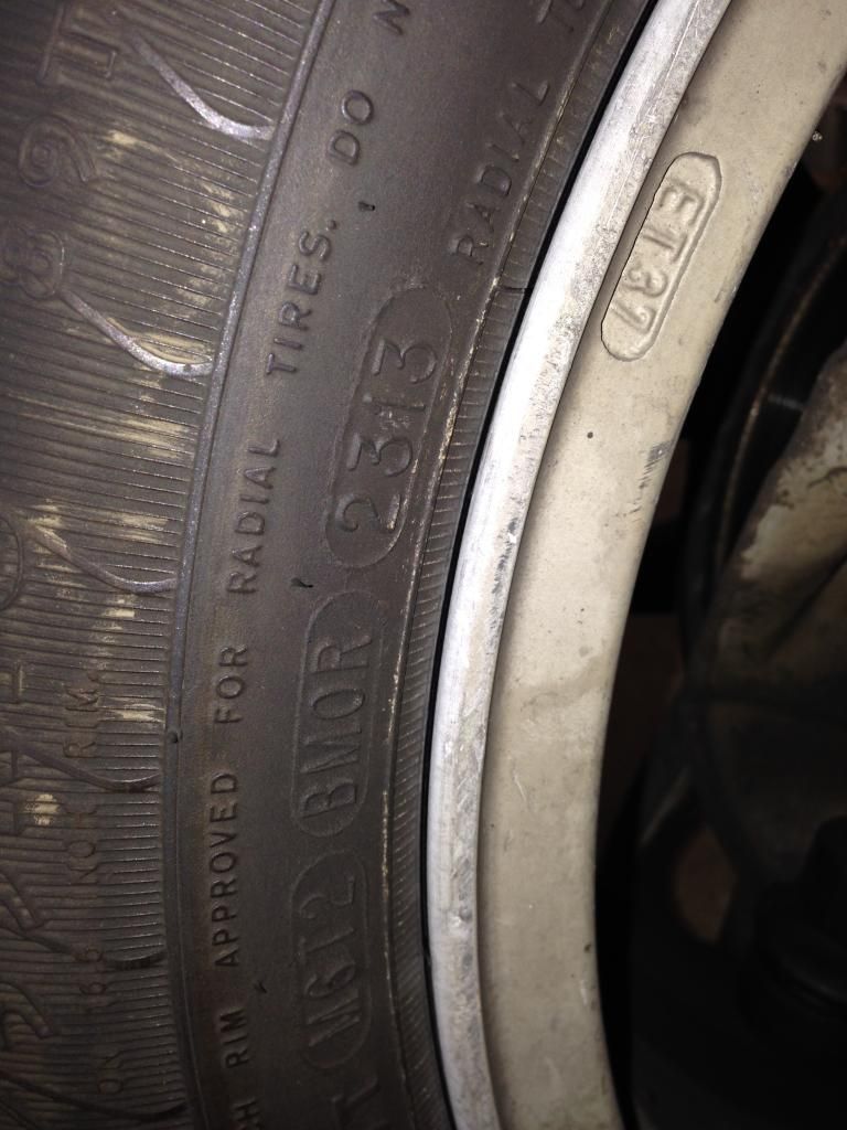

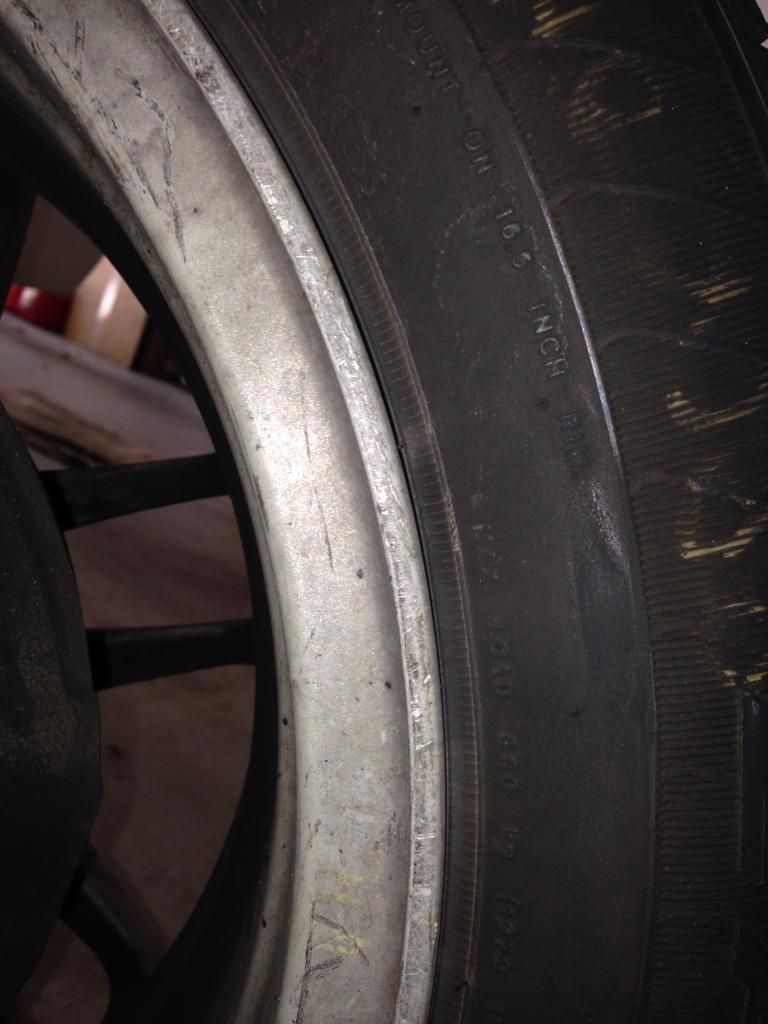

    I have some 16x7 OZ wheels with ET37 offset and 205/55/16 tires on them.
    I got them put on last summer and drove them from Miami to GA and have been using em since. Now I realize that I need spacers on the front and that they have been rubbing on strut, I thought I may have needed them before but I thought someone at alignment shop or other shops I've taken it to since would have noticed and let me know if I did(even though I know it is not their responsibility).

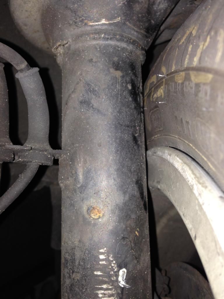

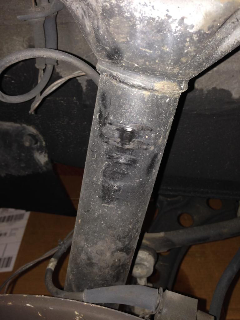

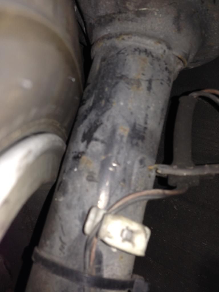

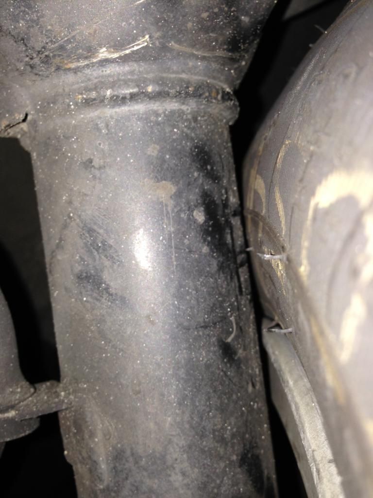

    Just took wheel off front driver side and took pics of the strut. I am going back to Miami this Monday and don't think I will be able to get spacers by then, would I be able to wait until I get down to get them there? My dad is a bmw mechanic and doing car stuff is easier down there. Drive is about 550 miles/8 hours. Or should I not risk it? ANY input would be greatly appreciated.
    And what size spacers would I need? 10mm and would it require longer lug bolts
    Thanks
    driver side
    you can kinda see where strut has rubbed tire right under the thick middle line in third pic
    back of tire on driver side
    passenger side

    looks like you only need a pretty thin spacer. HOWEVER, there is no replacement for figuring it out yourself.
    Quoted from IE.
    "Not sure what size you need? A simple "shade-tree" solution used to determine what size spacer is to grab a handful of 12mm washers. Stack the washers onto at least two of your wheel studs. At various intervals, test your wheel fitment. After determining your wheel's optimal fitment, take the washers off and measure the thickness of the stack of washers. Then find a spacer in the closest available size.
    Not sure if your nut has enough thread contact? A simple "shade-tree" rule-of-thumb is that the nut should be turned onto the stud enough to equal the thickness of the stud itself. With the 12x1.5 thread pitch, this equates out to roughly 7-8 full turns of the nut."

              15mm will give you a nice fit. You should run at least the same in the rear though.
