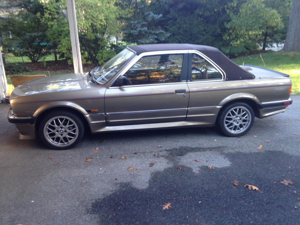

                    ESM-002R for E30 Baur (stock)
                    Am interested in running ESM-002R's 16x8 ET20 with 205-50's....my e30 is stock ride height and suspension. Is this a straight bolt on package without spacers or fender rolling? I have seen conflicting information in previous posts and other threads specific to ESM wheels.
                    If anybody is willing to photo shop ESM-002R's onto the attached E30 Baur with the following variations wheel lip/center I would be extremely greatful:
                    silver/silver
                    silver/gold
                    bronze/black
                    Thanks!
                    JB
                    Massachusetts
                    '85 323i Baur
                    • Mwishlist
                      • Jul 2013
                      • 505
                      I'm running the same wheel and tire combination. It was bolt on for my car and I am running a little lowered with a ground control coilover set up. My rears may have been rolled a bit before but I am not sure. At stock ride height, I can't imagine you would have any issues.
