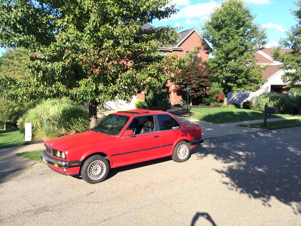

    Hey guys I'm sorry if i'm posting this in an incorrect section but I was wondering what the best tire size for a 16x8 et 20 bbs rep on a stock suspension 88' 325iX. I do plan to go about 2" lower in the future but I Still wan them to have some meat. Thanks guys! Heres a photo of my New iX.Click image for larger version

    205/50/16 is the best choice. Maintains the stock overall diameter.

        16X8 et20 isn't going to fit well. It will rub badly and look like a donk. They wont fit at all if you lower it.

                Yeah, ix is way different. You'd need et30 to et35 for it to work. I suggest et35 and adjust with small spacers to adjust.

                          Et20 is too low. Even et25 will rub with stock size tires.
