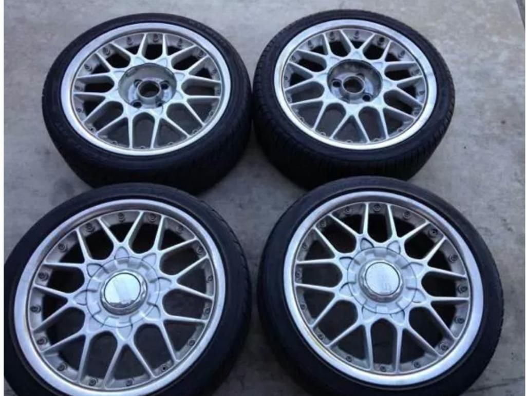

Can't get my wheels to fit
  • Bimmer_man
    • Jan 2013
    • 1477
    So I got these wheels they are the right lug but they won't so on the hub of my ix. There is this red ring in there that has a snap ring holding it in place. Do the ix cars have thicker hubs er something?
    The wheels are bbs rs715

    Rwd and ix cars have the same hub size, I think it's 57.1 or something. Make sure there bit hitting your calipers, I had this problem with bbs style 5's until I looked at it again

      Hmm I didn't even think to look Haha. I'll check then I'll see I may need spacers then.

        Well I feel like an idiot Haha. Apparently these wheels are hubcentric wheels so all J need to do is replace the Rings with e30 specific rings and boom they will fit. I guess these wheels where mounted on a Honda so Haha.
