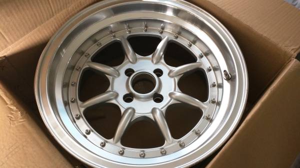

    will 0 offset 16 x 8 wheels fit without having to use spacers with stock suspension?

    You will probably need to roll with 16x8 et0, spacers would make it worse.

      these are the wheels. I guess I should check with the seller to see if he had his fenders rolled. Are you saying that they would fit fine with no spacers. I have never been clear on the offset thing. I have heard that stock offset for and e30 is +25, +30 and +45. Don't know which is right and if the offset is necessary.

        Offset is extremely necessary. Offset is the distance from the hub mounting surface to the centerline of the wheel. All 8" wide et0 wheels will measure the same, but you can't say that all 8" wide et0 wheels will fit an e30 due to the shape of the back of the spokes.
        I'm 95% sure those particular wheels will fit without spacers, but they will stick out way more than stock and might require a fender roll depending on how low your car is. 8" wide et20 is usually a safe bet for e30's without needing a fender roll.

          Zero moves the wheel out compared to a stock e30 wheel. Zero means the center of the wheel is the same as the mounting surface to go on the car. et25 means the lip of the wheel will move in 25mm compared to an et0 (offset). You are going from a 6" to 8" wheel and moving the lip out 25mm or so (1") on top of that.

            It will fit with no inner clearance issue.
            Rear fenders must be rolled, especially if you are lowered any amount.
            You should also roll the fronts or the tire will catch fender when you enter driveways or hit bumps at an angle.
