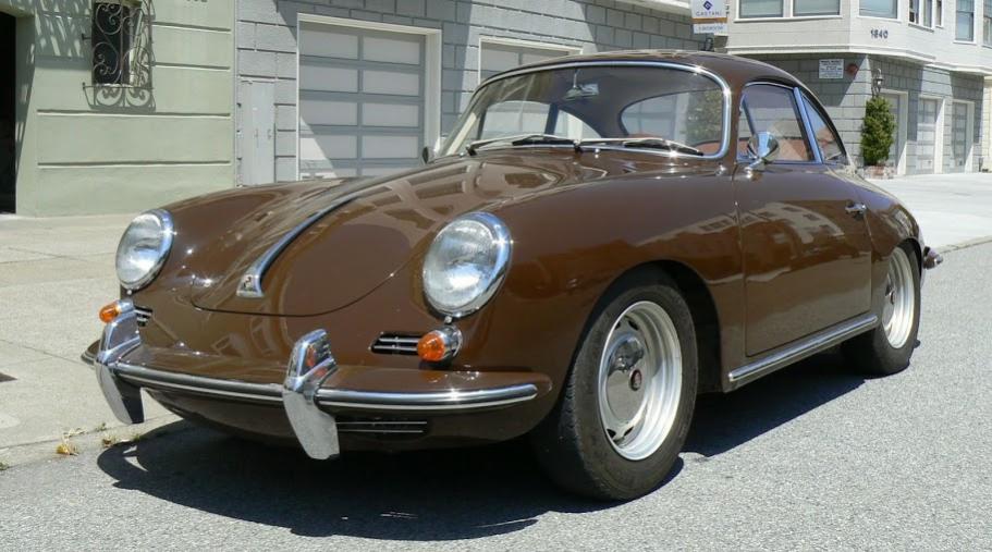

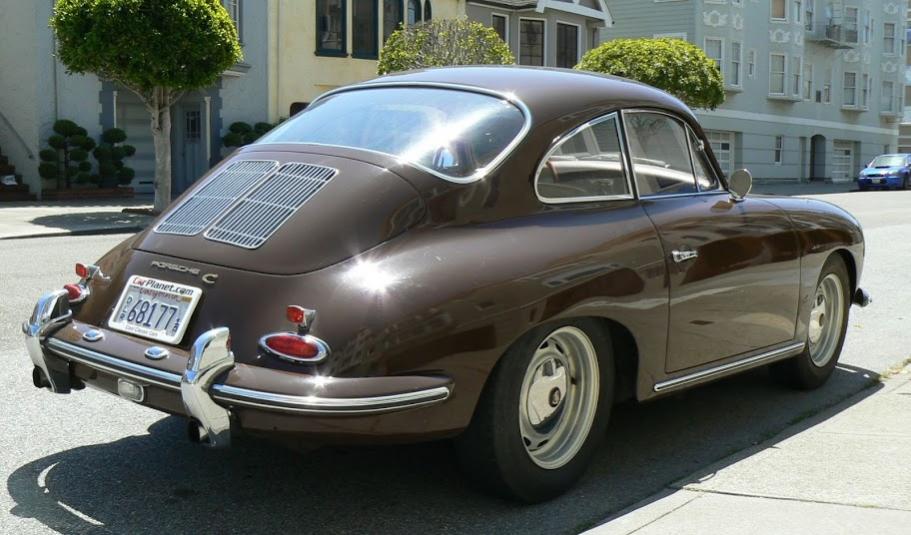

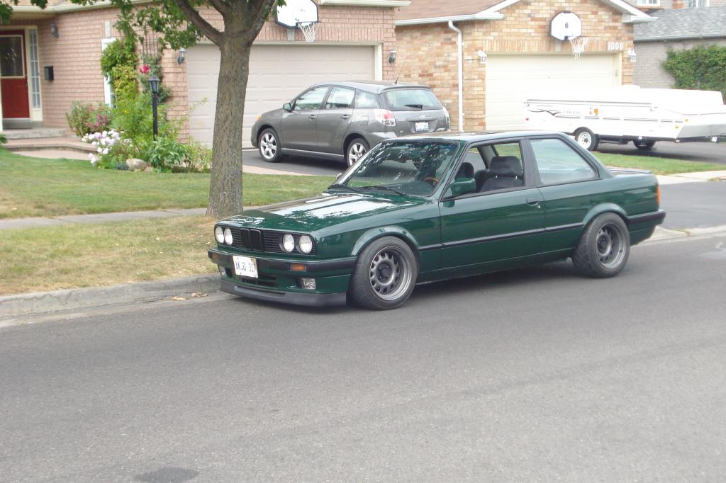

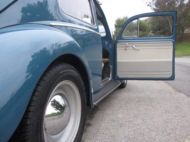

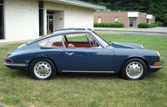

                      Originally posted by CrusherCurtis
                      Any one know where to get steel wheels widened? Going for this look:
                      ^^^ I love this, with OEM chrome dog dishes.
                      I've been trying to find people to do this to some old Alfa wheels. Used to be hot rodders everywhere who could do this, but I think liability scared everyone. You see crazy old Polish guys in youtube videos doing it in a dirt-floored shop - hope they come out straight!
                      The two ways I've seen this done are banding it with a strip, which puts all the extra width either inside or outside, or cutting the welds on your old centers and putting them in a wider (and plus 1") barrel from another car. The barrels are dirt cheap at wrecking yards. Then you can get the offset you want just right.
                      Good luck, tell us what you find.

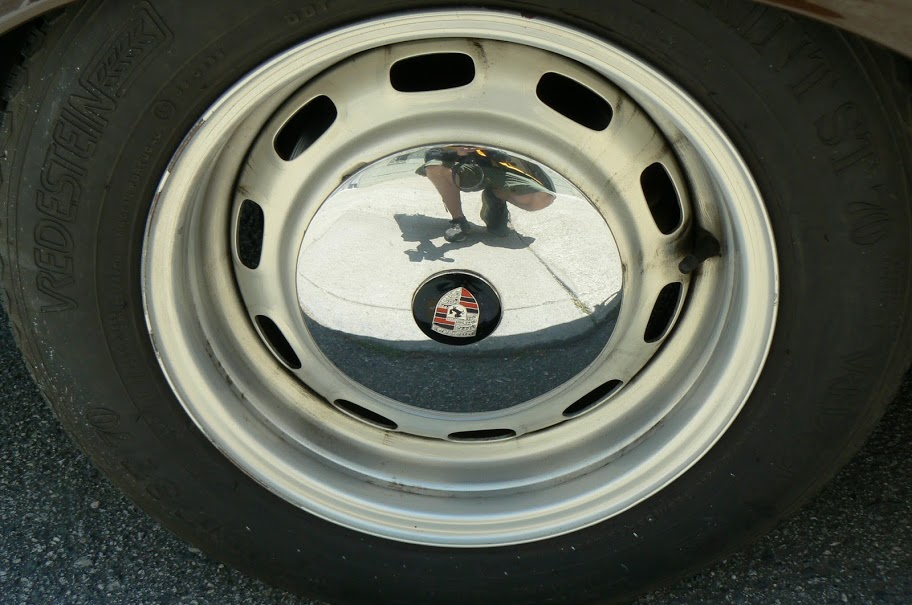

                          These must be widened. They don't look stock.

                          • ELVA164
                            • 4861
                            Definitely not stock.
                              Any one know where to get steel wheels widened? Thinking of getting a set of donuts widended. OR does anyone know where to buy 17" steelies custom? I think diamond racing only goes to 16. Going for this look:
                              These look like the face was flipped, not widened.
